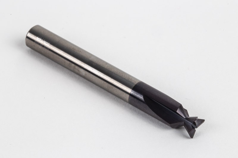

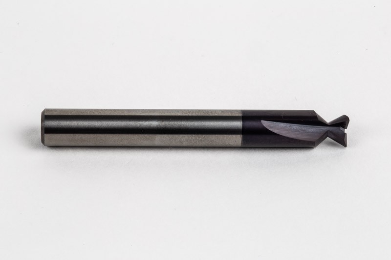

This 60-degree 3-flute carbide dovetail cutter has a 8mm cutting diameter, with a 8mm smooth shank, 3.96mm length of cut (LOC), 0.25mm corner radius, and a 64mm overall length. It is AlTiN coated, and made to cut steel, stainless steel, cast iron, high temp. alloys, and hardened metals.

TIPS:
  • Rough slots with an end mill first
  • Calculate feedrates based on the smaller neck diameter
  • Calculate speeds based on the larger end diameter
  • Take shallow depths of cut

[ØDC] Cutting Diameter 8.0 mm
[ØDMM] Shank Diameter 8.0 mm
[ØN] Neck Diameter 3.73 mm
[LOC] Length Of Cut 3.96 mm
[OAL] Overall Length 64.0 mm
[NOF] Number of Flutes 3
[CHW\RE] Chamfer \ Radius Size 0.25 mm
[SIG°] Included Angle 60
Cutting Direction Right
Country of Origin USA
