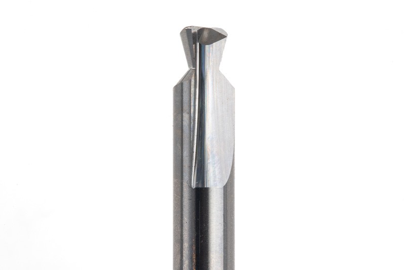

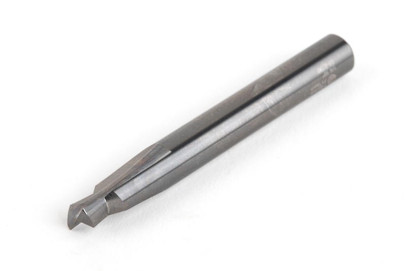

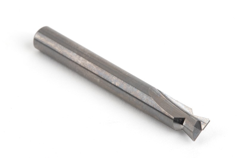

This 30-degree 2-flute carbide dovetail cutter has a 0.25 in \ 1/4" cutting diameter, with a 1/4" smooth shank, 0.156" length of cut (LOC), 0.01" corner radius, and a 2" overall length. It is uncoated, and made to cut aluminum/non-ferrous materials.
