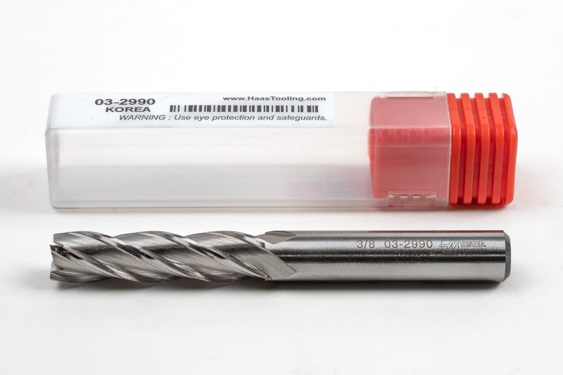

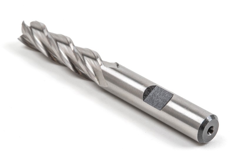

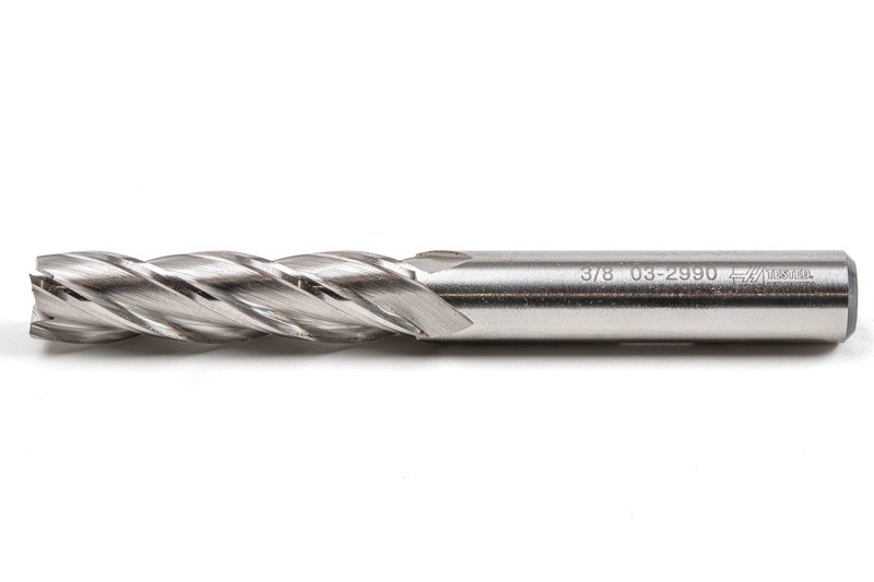

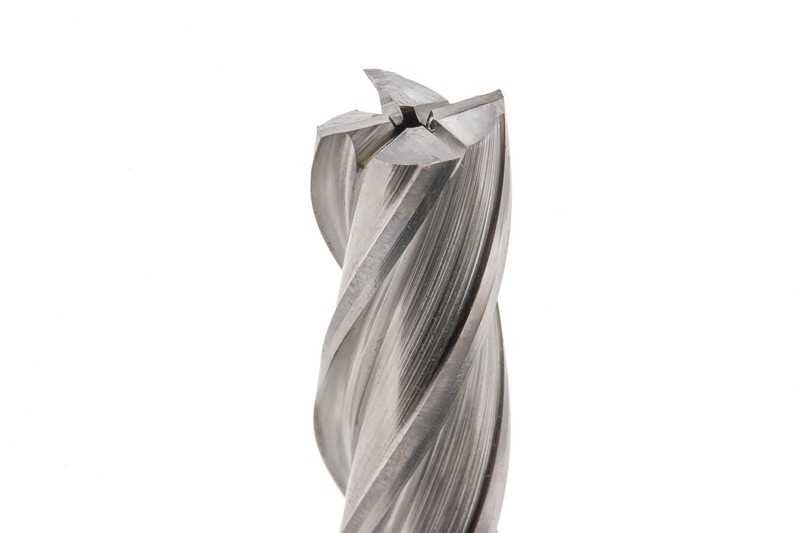

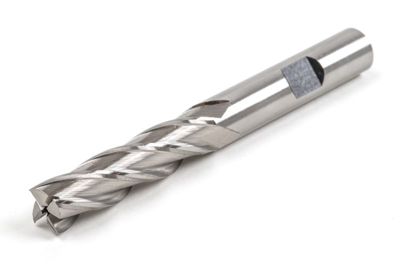

3/8" Dia. Cobalt End Mill, 4 Flute, Uncoated, 3/8" Weldon Shank x 1-1/2" LOC, Square Profile, HM42
Part #: 03-2990
EM M42 4FL 3/8x3/8x1-1/2x3-1/4" ,WF
Price: 16.95 ( / unit)
12.97
This HM42 4-flute HSSCo8 (M42) cobalt end mill has a 0.375 in \ 3/8" cutting diameter, with a 3/8" weldon shank, 1-1/2" length of cut (LOC), square profile, and a 3-1/4" overall length. It is uncoated, and made to cut steel and aluminum/non-ferrous materials. This end mill is NOT designed to center-cut.
ISO Material Chart
[ØDC] Cutting Diameter 0.375 in \ 3/8"
Haas Milling Series HM42
Primary Workpiece Material N - Aluminum, P - Steel
Material HSSCo8 (M42)
Coating Uncoated
Corner Type Square
Shank Type Weldon
[ØDMM] Shank Diameter 0.375 in
[LOC] Length Of Cut 1.5 in
[OAL] Overall Length 3.25 in
[NOF] Number of Flutes 4
[FHA°] Helix Angle 30
Cutting Direction Right
Center Cutting No
Variable Pitch No
Through Spindle Coolant No
