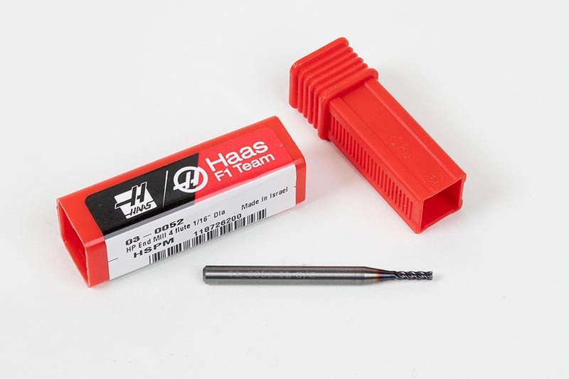

This HSPM1 4-flute carbide end mill has a 0.0625 in \ 1/16" cutting diameter, with a 1/8" smooth shank, 3/16" length of cut (LOC), 0.004" chamfer, and a 1-1/2" overall length. It is TiAlN coated, and made to cut steel, stainless steel, and high-temp. alloys, but is capable of cutting some grades of cast iron and hardened metals. This end mill is designed to center-cut, and the unique, variable pitch configuration helps to reduce unwanted harmonics and vibrations.

[ØDC] Cutting Diameter 0.0625 in \ 1/16"
Haas Milling Series HSPM1
Primary Workpiece Material S - High Temp Alloys, M - Stainless Steel, P - Steel
Secondary Workpiece Material K - Cast Iron, H - Hardened Materials
Material Carbide
Coating Multi-Layer TiAlN
Corner Type Chamfer
Shank Type Smooth
[ØDMM] Shank Diameter 0.125 in
[LOC] Length Of Cut 0.188 in
[OAL] Overall Length 1.5 in
[NOF] Number of Flutes 4
[CHW\RE] Chamfer \ Radius Size 0.004 in
[FHA°] Helix Angle 38
Cutting Direction Right
Center Cutting Yes
Variable Pitch Yes
Through Spindle Coolant No
Country of Origin Various
