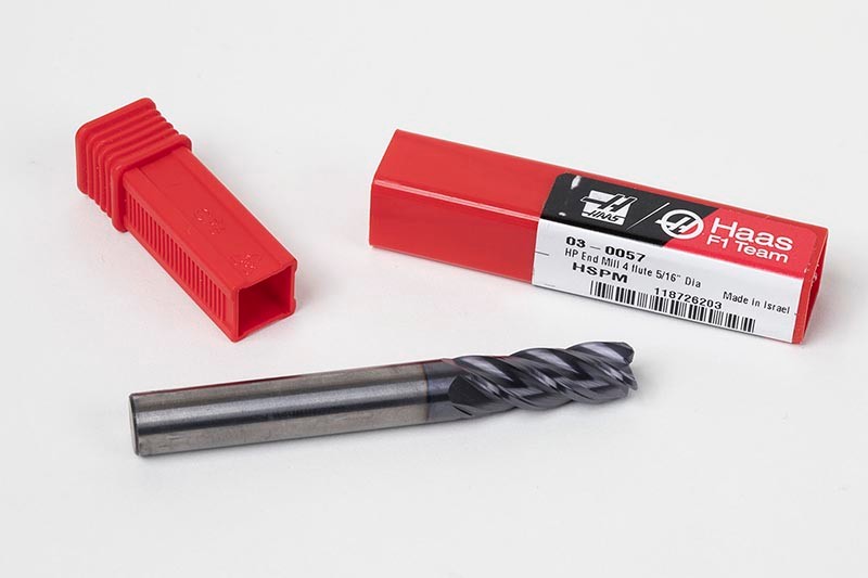

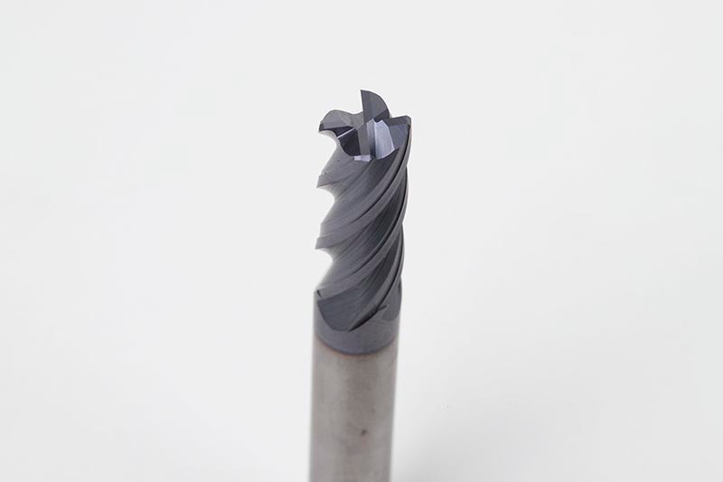

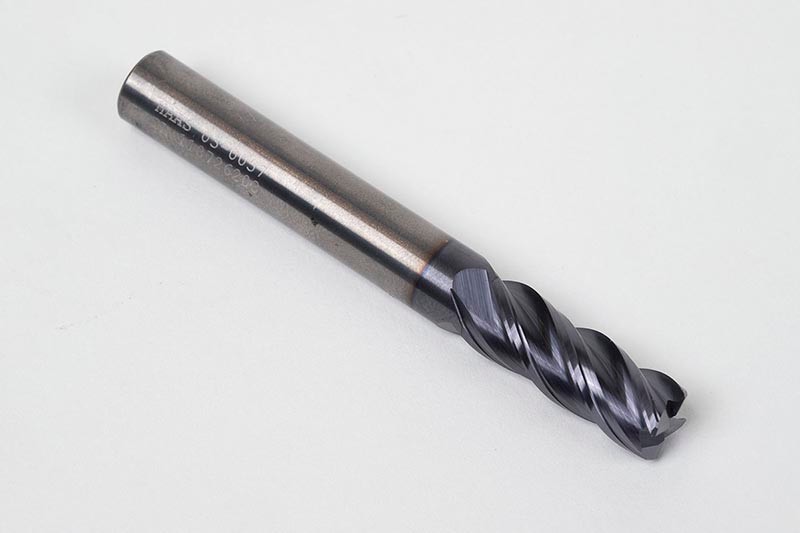

This HSPM1 4-flute carbide end mill has a 0.3125 in \ 5/16" cutting diameter, with a 5/16" smooth shank, 13/16" length of cut (LOC), 0.016" chamfer, and a 2-1/2" overall length. It is TiAlN coated, and made to cut steel, stainless steel, and high-temp. alloys, but is capable of cutting some grades of cast iron and hardened metals. This end mill is designed to center-cut, and the unique, variable pitch configuration helps to reduce unwanted harmonics and vibrations.

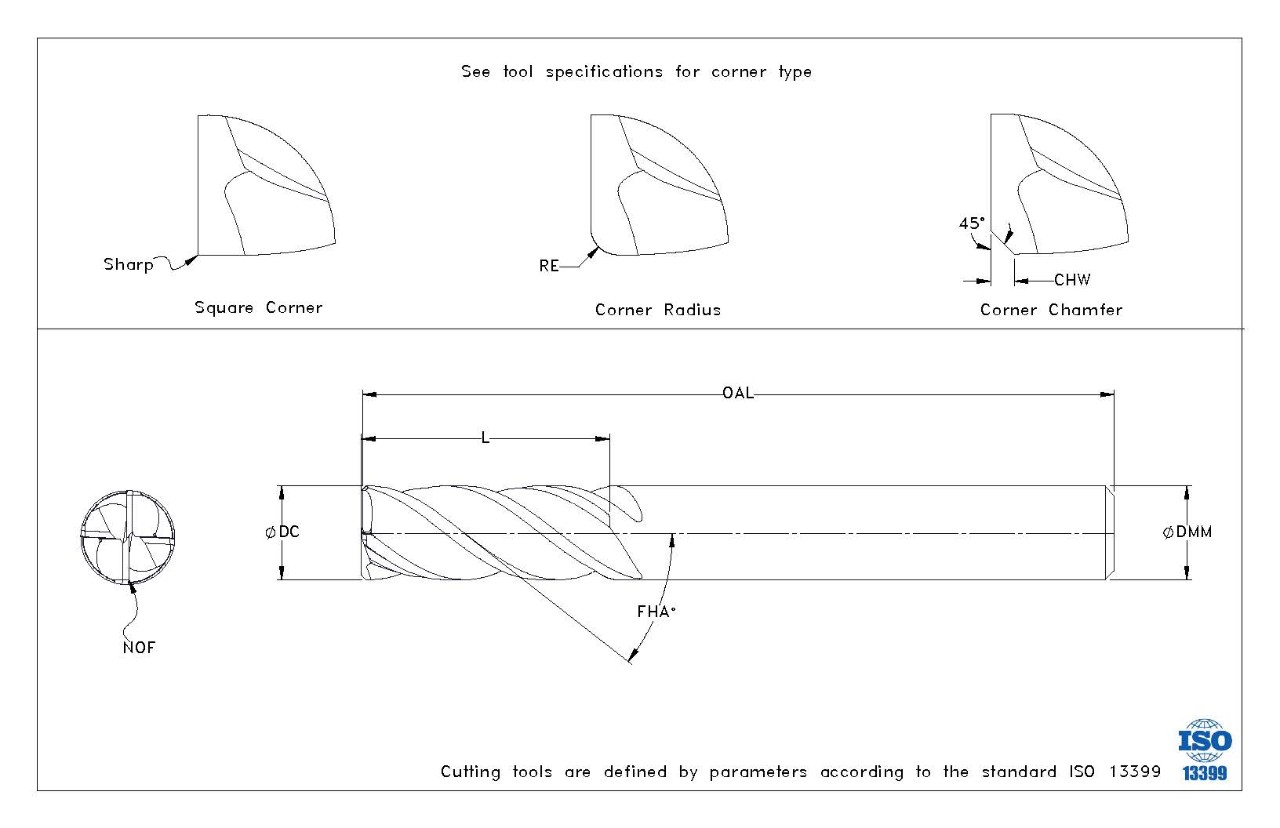

[ØDC] Cutting Diameter 0.3125 in \ 5/16"
Haas Milling Series HSPM1
Primary Workpiece Material S - High Temp Alloys, P - Steel, M - Stainless Steel
Secondary Workpiece Material H - Hardened Materials, K - Cast Iron
Material Carbide
Coating Multi-Layer TiAlN
Corner Type Chamfer
Shank Type Smooth
[ØDMM] Shank Diameter 0.3125 in
[LOC] Length Of Cut 0.813 in
[OAL] Overall Length 2.5 in
[NOF] Number of Flutes 4
[CHW\RE] Chamfer \ Radius Size 0.016 in
[FHA°] Helix Angle 38
Cutting Direction Right
Center Cutting Yes
Variable Pitch Yes
Through Spindle Coolant No
Weight 0.2 lbs \ 0.1 kg
Country of Origin Various
