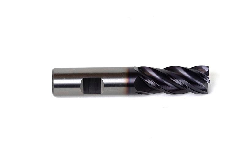

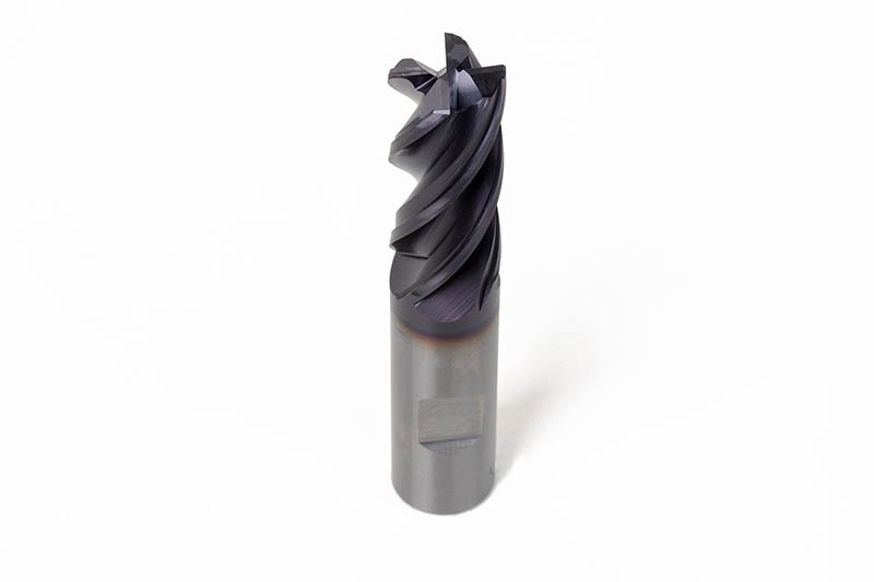

3/4" Dia. Carbide End Mill, 4 Flute, TiAlN Coated, 3/4" Weldon Shank x 1-5/8" LOC, 0.02" Chamfer, HSPM1
Part #: 03-0064
HP EM 4 FLUTE 3/4" DIAMETER W/FLAT
Price: 98.95 ( / unit)
74.97
This HSPM1 4-flute carbide end mill has a 0.75 in \ 3/4" cutting diameter, with a 3/4" weldon shank, 1-5/8" length of cut (LOC), 0.02" chamfer, and a 4" overall length. It is TiAlN coated, and made to cut steel, stainless steel, and high-temp. alloys, but is capable of cutting some grades of cast iron and hardened metals. This end mill is designed to center-cut, and the unique, variable pitch configuration helps to reduce unwanted harmonics and vibrations.

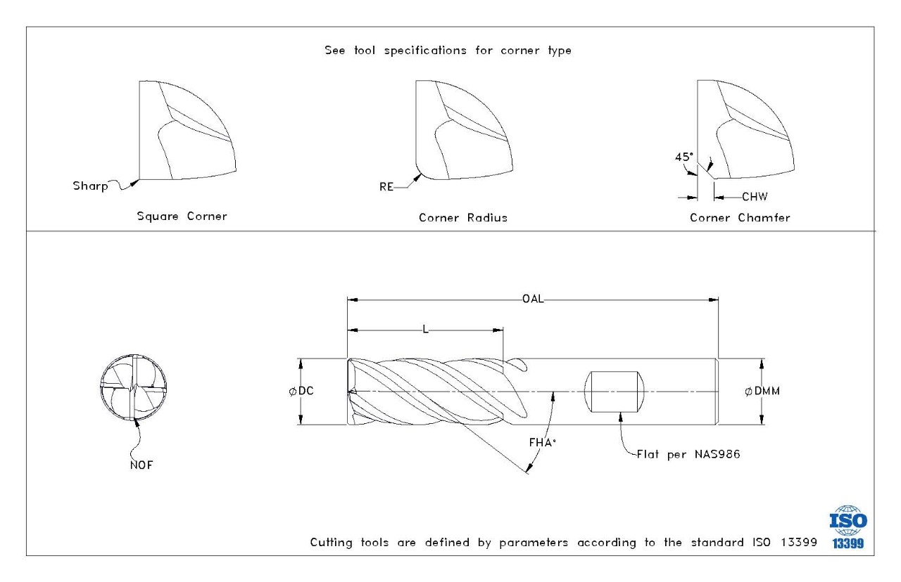

  • Haas Drawing (PDF)

[ØDC] Cutting Diameter 0.75 in \ 3/4"
Haas Milling Series HSPM1
Primary Workpiece Material P - Steel, M - Stainless Steel, S - High Temp Alloys
Secondary Workpiece Material H - Hardened Materials, K - Cast Iron
Material Carbide
Coating Multi-Layer TiAlN
Corner Type Chamfer
Shank Type Weldon
[ØDMM] Shank Diameter 0.75 in
[LOC] Length Of Cut 1.625 in
[OAL] Overall Length 4.0 in
[NOF] Number of Flutes 4
[CHW\RE] Chamfer \ Radius Size 0.02 in
[FHA°] Helix Angle 38
Cutting Direction Right
Center Cutting Yes
Variable Pitch Yes
Through Spindle Coolant No
Weight 1.0 lbs \ 0.5 kg
Country of Origin Various
