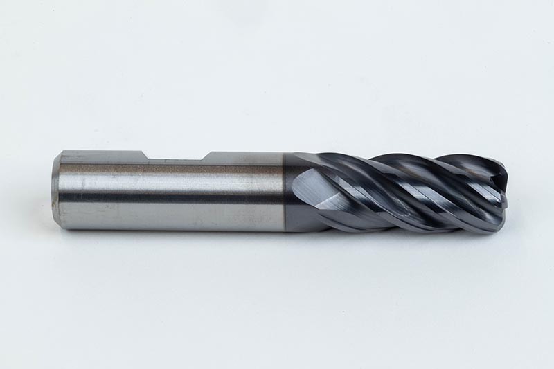

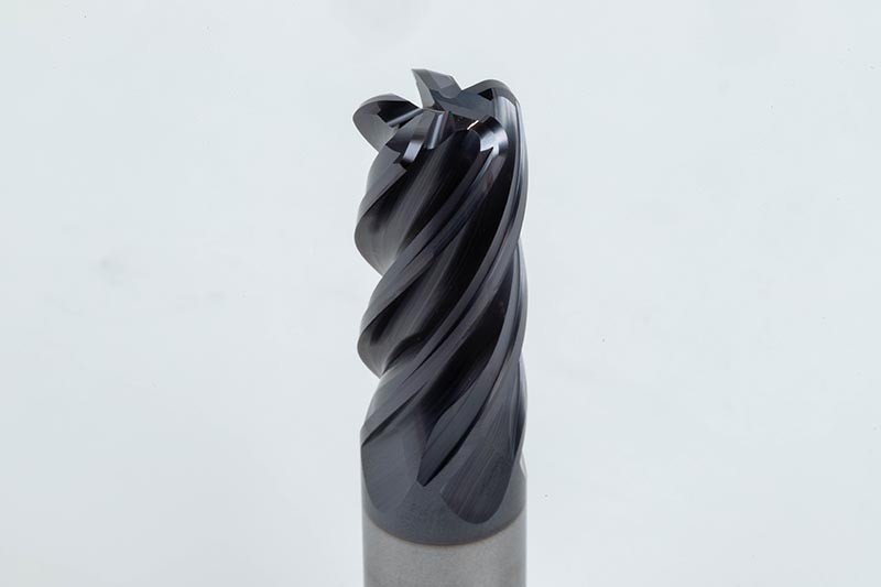

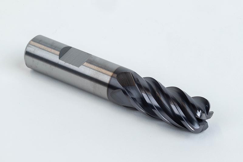

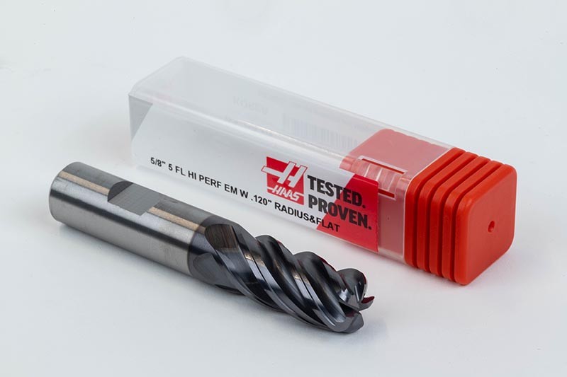

5/8" Dia. Carbide End Mill, 5 Flute, AlTiN Coated, 5/8" Weldon Shank x 1-1/4" LOC, 0.12" Radius, HTM
Part #: 03-0640
5/8" 5 FL HI PERF EM W .120" RADIUS & FL
Price: 68.95 ( / unit)
This HTM 5-flute carbide end mill has a 0.625 in \ 5/8" cutting diameter, with a 5/8" weldon shank, 1-1/4" length of cut (LOC), 0.12" radius, and a 3-1/2" overall length. It is AlTiN coated, and made to cut stainless steel and high-temp. alloys, but is capable of cutting some grades of steel and cast iron. This end mill is designed to center-cut, and the unique, variable pitch configuration helps to reduce unwanted harmonics and vibrations.
ISO Material Chart
[ØDC] Cutting Diameter 0.625 in \ 5/8"
Haas Milling Series HTM
Primary Workpiece Material S - High Temp Alloys, M - Stainless Steel
Secondary Workpiece Material P - Steel, K - Cast Iron
Material Carbide
Coating AlTiN
Corner Type Radius
Shank Type Weldon
[ØDMM] Shank Diameter 0.625 in
[LOC] Length Of Cut 1.25 in
[OAL] Overall Length 3.5 in
[NOF] Number of Flutes 5
[CHW\RE] Chamfer \ Radius Size 0.12 in
[FHA°] Helix Angle 38
Cutting Direction Right
Center Cutting Yes
Variable Pitch Yes
Through Spindle Coolant No
Weight 0.9 lbs \ 0.4 kg
