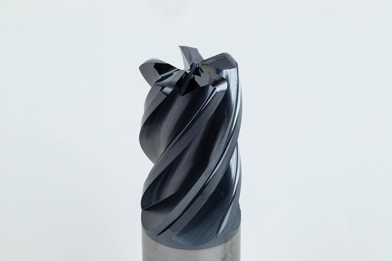

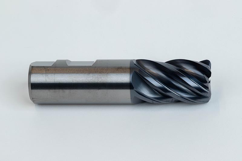

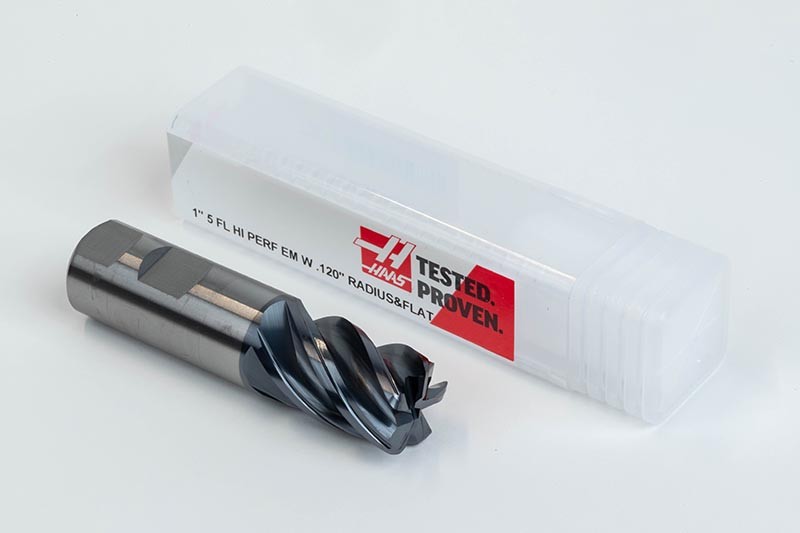

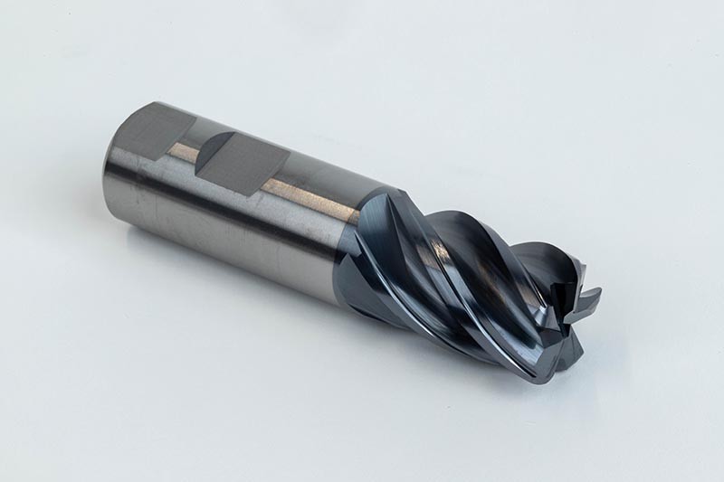

1" Dia. Carbide End Mill, 5 Flute, AlTiN Coated, 1" Weldon Shank x 1-1/2" LOC, 0.12" Radius, HTM
Part #: 03-0648
1" 5 FL HI PERF EM W .120" RADIUS & FLAT
Price: 166.95 ( / unit)
This HTM 5-flute carbide end mill has a 1.0 in \ 1" cutting diameter, with a 1" weldon shank, 1-1/2" length of cut (LOC), 0.12" radius, and a 4" overall length. It is AlTiN coated, and made to cut stainless steel and high-temp. alloys, but is capable of cutting some grades of steel and cast iron. This end mill is designed to center-cut, and the unique, variable pitch configuration helps to reduce unwanted harmonics and vibrations.
ISO MATERIAL CHART
[ØDC] Cutting Diameter 1.0 in \ 1"
Haas Milling Series HTM
Primary Workpiece Material M - Stainless Steel, S - High Temp Alloys
Secondary Workpiece Material P - Steel, K - Cast Iron
Material Carbide
Coating AlTiN
Corner Type Radius
Shank Type Weldon
[ØDMM] Shank Diameter 1.0 in
[LOC] Length Of Cut 1.5 in
[OAL] Overall Length 4.0 in
[NOF] Number of Flutes 5
[CHW\RE] Chamfer \ Radius Size 0.12 in
[FHA°] Helix Angle 38
Cutting Direction Right
Center Cutting Yes
Variable Pitch Yes
Through Spindle Coolant No
Weight 1.6 lbs \ 0.7 kg
