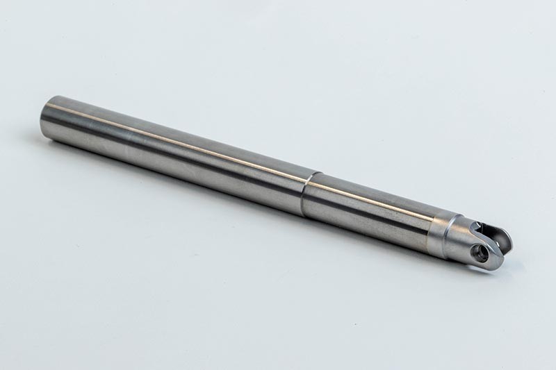

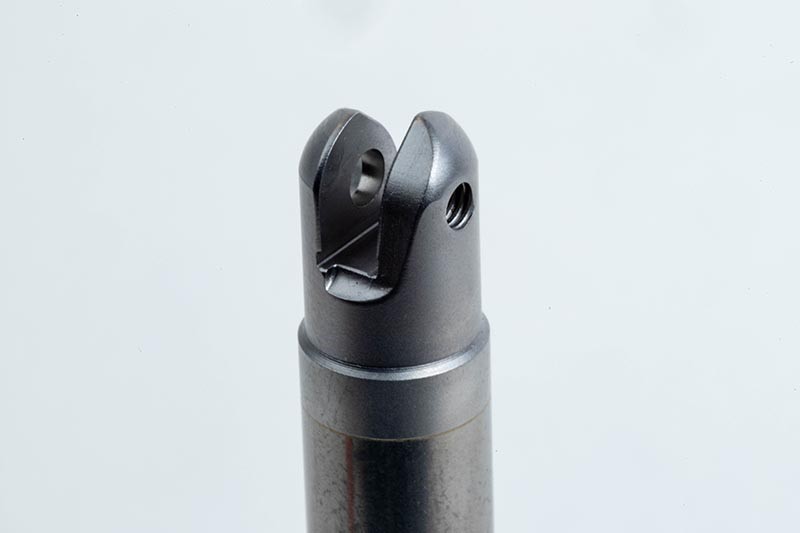

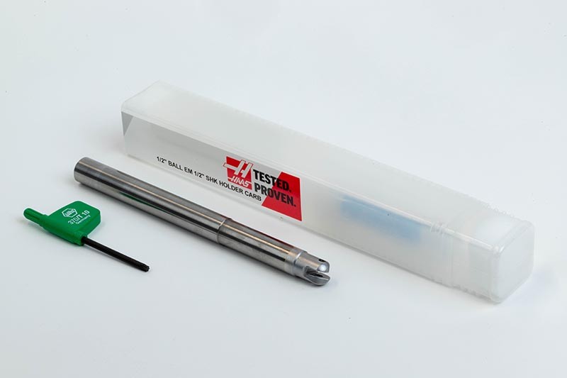

1/2" Diameter Indexable Ball End Mill, 1/2" Straight Carbide Shank x 5-15/16" Overall Length x 2-3/8" Neck Length, 1 Insert
Part #: 01-0233
1/2" BALL EM 1/2" SHK HOLDER CARB
Customer Rating:
Price: $278.95 ( / unit)
$195.97
  • Technical Details
Tool Or Insert Tool
Material Carbide
Shank Type Smooth
[ØDC] Cutting Diameter 0.5 in \ 1/2"
[ØDMM] Shank Diameter 0.5 in
[ØN] Neck Diameter 0.484 in
[OAL] Overall Length 5.938 in
[LH] Head Length 0.688 in
[LN] Neck Length 2.375 in
[R1] Radius 0.25 in
[Z] Number of Cutting Teeth 1
Through Tool Coolant No
Weight 0.6 lbs \ 0.3 kg
01-0233
T10 Torx Wrench, TWF10
Part #: 06-0351
