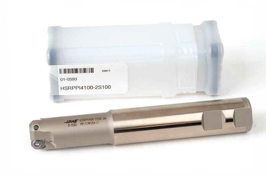

HRPP, 1" Ø Indexable End Mill, 1" Shank x 11° Lead Angle x 6.299" Overall Length, 2 Flute, TSC
Part #: 01-0593
HSRPPI4100-2S100
Customer Rating:
Price: $141.95 ( / unit)
$127.97
$121.57 (Save 5%)
  • Technical Documents
Milling Cutter Series HRPP - Haas Round + / +
Toolpath Type Shoulder Milling, Helical Milling, Copy Milling, Slotting, Ramping, Face Milling
Shank Type Weldon
[ØDC] Cutting Diameter 1.0 in \ 1"
[ØDCN] Min. Cutting Diameter 0.528 in
[°] Lead Angle 11 Degree
[Z] Number of Cutting Teeth 2
[ØDMM] Shank Diameter 1.0 in
[LH] Head Length 2.362 in
[Ap] Max. Cutting Depth 0.236 in
[OAL] Overall Length 6.299 in
Maximum RPM 12000
Torque of Insert Screw 300 Ncm
Through Tool Coolant Yes
Weight 1.0 lbs \ 0.5 kg

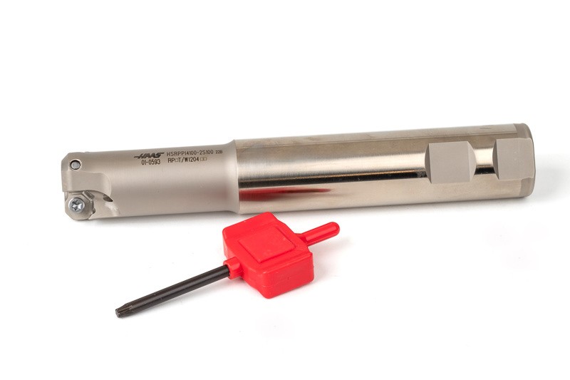

T15 Torx Screwdriver, TW15S
