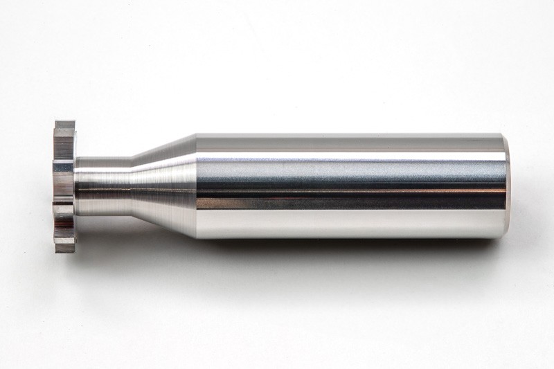

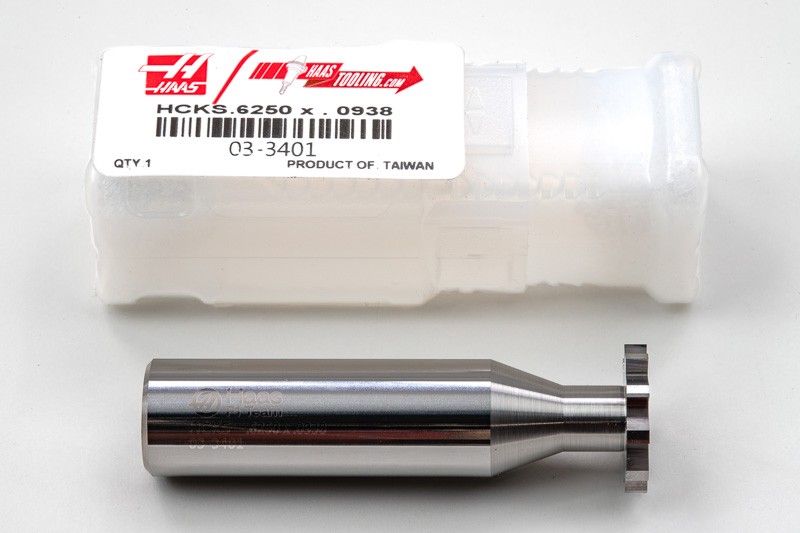

5/8" Dia. Carbide Straight Tooth Keyseat Cutter, 10 Flute, Uncoated, 1/2" Smooth Shank x 3/32" Cut Width
Part #: 03-3401
HCKS .6250 x .0938
Price: 79.95 ( / unit)
This 10-flute carbide straight tooth keyseat cutter has a 0.625 in \ 5/8" cutting diameter, with a 1/2" smooth shank, 3/32" cut width, and a 2-3/32" overall length. It is uncoated, and made to cut steel, stainless steel, cast iron, aluminum/non-ferrous materials, and high temp. alloys.
ISO MATERIAL CHART
Primary Workpiece Material K - Cast Iron, N - Aluminum, M - Stainless Steel, S - High Temp Alloys, P - Steel
Material Carbide
Coating Uncoated
Tooth Type Straight
Shank Type Smooth
[ØDC] Cutting Diameter 0.625 in \ 5/8"
Cutting Diameter Tolerance + 0 \ - 0.0047 in
[ØDMM] Shank Diameter 0.5 in
[ØN] Neck Diameter 0.281 in
[CW] Cutting Width 0.094 in
[OAL] Overall Length 2.094 in
[NOF] Number of Flutes 10
Cutting Direction Right
Weight 0.2 lbs \ 0.1 kg
Country of Origin Taiwan
