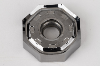

HOP – Haas Octagon Positive
Toolpath Type: Face Milling
45° cutting edge | D.O.C. max. 0.138" (3.5mm)
• Positive axial rake, positive radial rake
• 45-degree cutting edge
• Inserts have 8 cutting edges
• Screw clamping

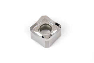

HSNP – Haas Square Negative Positive
45° cutting edge | D.O.C. max. 0.275" (7.0mm)
• Negative axial rake, positive radial rake
• Double-sided, extra-thick insert with 8 cutting edges
• Large rake angle reduces cutting forces
• Wiper insert geometry for good surface quality

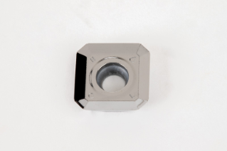

HSHF – Haas Square High Feed
Toolpath Type: Face Milling, Slotting, Ramping, Helical Milling, Copy Milling, Axial Plunge Milling
15° cutting edge | D.O.C. max. 0.071" (1.8mm)
• 15-degree high feed mill
• Inserts with 4 cutting edges
• Ramping possible
• Double clamping system for inserts

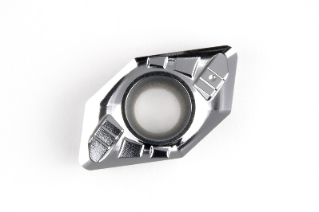

HPAL – Haas High Positive for Aluminum
Toolpath Type: Face Milling, Shoulder Milling, Slotting, Ramping, Helical Milling, Copy Milling
90° cutting edge | D.O.C. max. 0.67" (17.0mm)
• Designed for high-speed machining of aluminum
• Buffed surface for smooth chip evacuation and reduced BUE
• High rake angle for good surface finish and lower cutting loads
• For square shoulder milling and curved surface machining

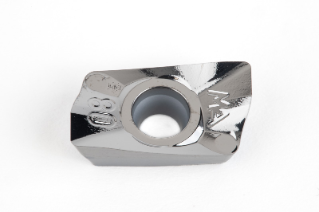

HIEX/HPSM – Haas High Positive Shell Mill
90° cutting edge | D.O.C. max. 0.649" (16.5mm)
• Superior perpendicularity and minimized cutting loads
• Optimized for high-quality surface finishes
• High rake angle lowers cutting loads and minimizes burrs
• High-speed and high-feed capability improve productivity
