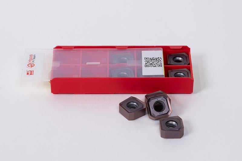

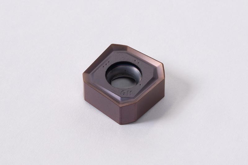

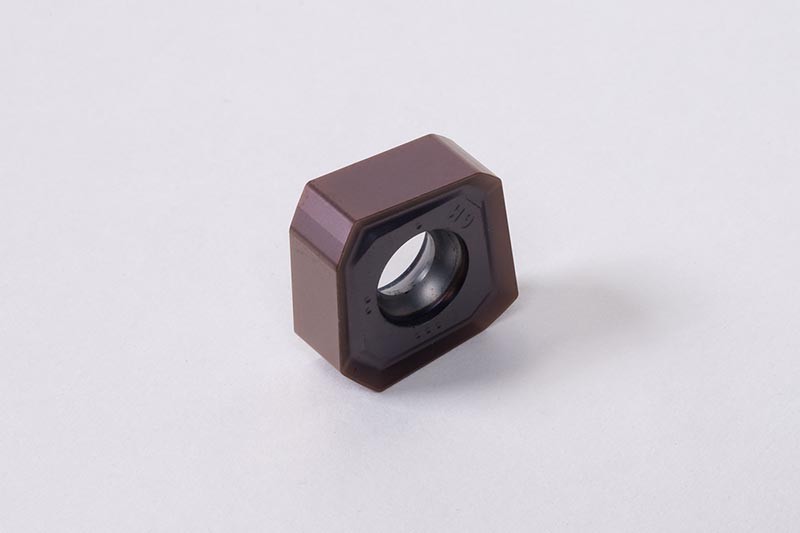

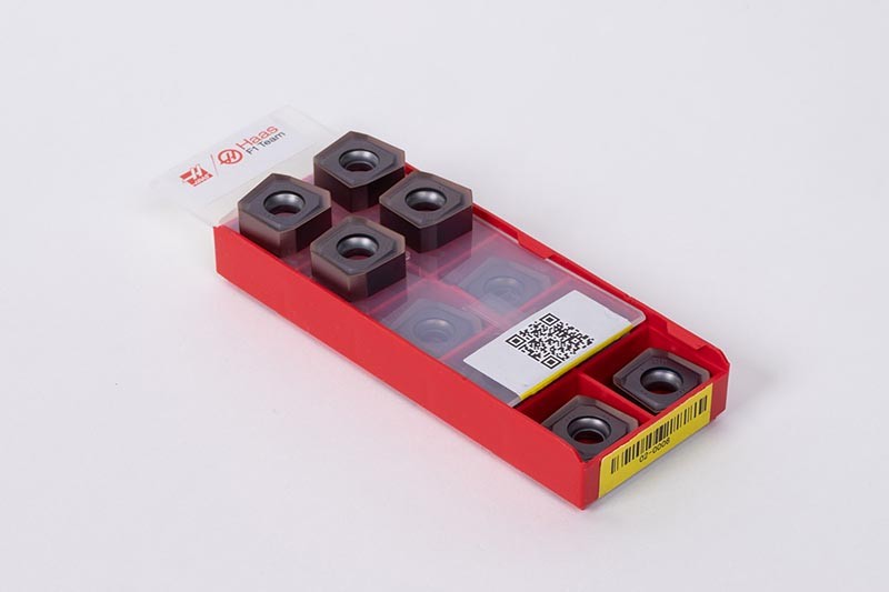

HSNP - Heavy and Medium Roughing, Face Milling
✓ Double-sided
✓ 8 cutting edges for longer durability per insert
✓ 45° cutting angle
✓ Slight rake on the cutting edge to reduce the banging of the insert
✓ Great for heavy depths of cuts
Insert Style
HSNP
HAAS SQUARE NEGATIVE POSITIVE
TOOLPATH TYPE
FACE MILLING
45° cutting edge | D.O.C. max. .271" (6.88mm)
• Negative axial rake, positive radial rake
• Double-sided, extra-thick insert with 8 cutting edges
• Large rake angle reduces cutting forces
• Wiper insert geometry for good surface quality
