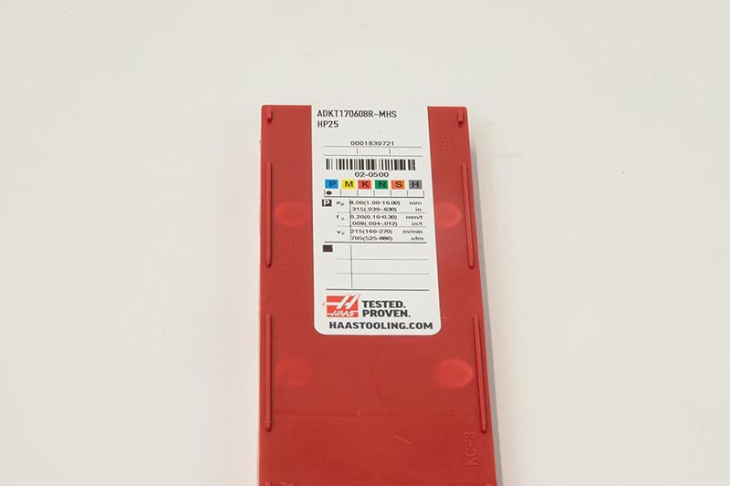

HIEX/HPSM, Carbide Indexable End Mill Insert, Rectangle, Grade HP25 - Pack of 10
Part #: 02-0500
ADKT170608R-MHS GRADE HP25

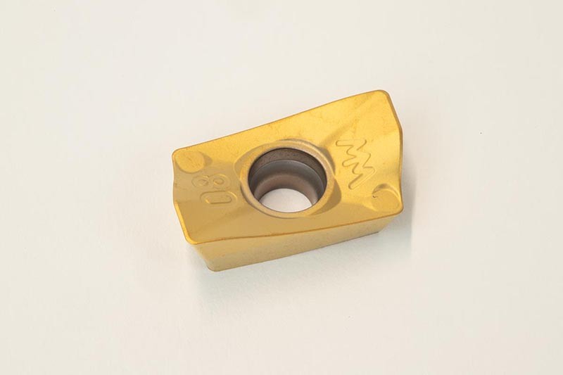

HIEX/HPSM - High-Quality Surface, Multiple Tooling Path Insert
✓ Great for a magnitude of applications
✓ Perfect for long-reach and general-purpose machining
✓ Can take large depths of cuts
✓ Capable of ramping, finishing, and roughing material
Insert Style
HIEX/HPSM
HAAS HIGH POSITIVE SHELL MILL
TOOLPATH TYPE
FACE MILLING, SHOULDER MILLING, SLOTTING, RAMPING, HELICAL MILLING, COPY MILLING
90° cutting edge | D.O.C. max. .649" (16.48mm)
• Superior perpendicularity and minimized cutting loads
• Optimized for high-quality surface finishes
• High rake angle lowers cutting loads and minimizes burrs
• High-speed and high-feed capability improve productivity

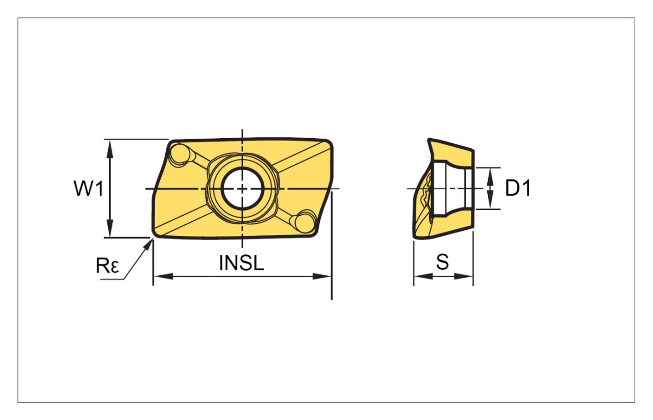

[IC] Inscribed Circle Diameter 0.427 in \ 10.84 mm
[INSL] Insert Length 0.774 in \ 19.65 mm
[RE] Corner Radius 0.032 in \ 0.8 mm
[D1] Insert Hole Size 0.177 in \ 4.5 mm
[S] Insert Thickness 0.257 in \ 6.53 mm
[Ap] Max. Cutting Depth 0.649 in \ 16.5 mm
