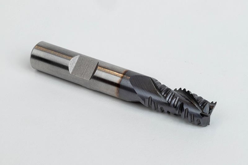

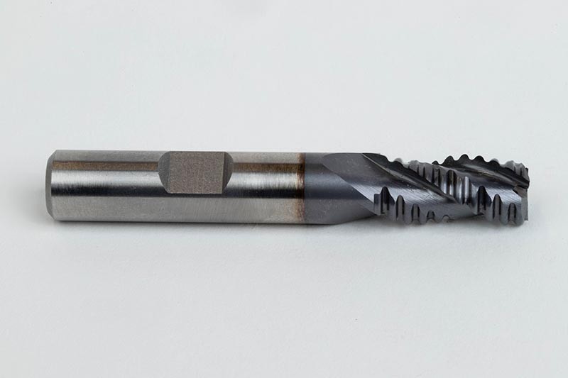

3/8" Dia. Cobalt Coarse Roughing End Mill, 3 Flute, TiCN Coated, 3/8" Weldon Shank x 3/4" LOC, 0.02" Chamfer, CPRA
Part #: 03-0506
REM-AL 3/8" M42 COARSE STD LGTH TICN
Price: 25.95 ( / unit)
23.97
This CPRA 3-flute HSSCo8 (M42) cobalt roughing end mill has a 0.375 in \ 3/8" cutting diameter, with a 3/8" weldon shank, 3/4" length of cut (LOC), 0.02" chamfer, and a 2-1/2" overall length. It is TiCN coated, and made to cut aluminum/non-ferrous materials. This roughing end mill is designed to center-cut.
ISO Material Chart
Haas Milling Series CPRA
Material HSSCo8 (M42)
Coating TiCN
Corner Type Chamfer
Shank Type Weldon
[ØDC] Cutting Diameter 0.375 in \ 3/8"
[ØDMM] Shank Diameter 0.375 in
[LOC] Length Of Cut 0.75 in
[OAL] Overall Length 2.5 in
[NOF] Number of Flutes 3
[CHW\RE] Chamfer \ Radius Size 0.02 in
[FHA°] Helix Angle 37
Cutting Direction Right
Center Cutting Yes
Variable Pitch No
Through Spindle Coolant No
