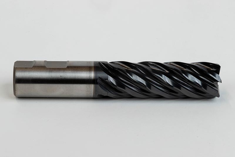

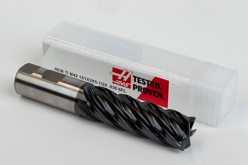

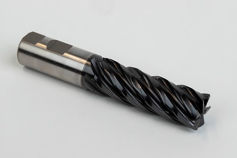

1" Dia. Cobalt Sine. Roughing End Mill, 6 Flute, Hyb. AlCrN Coated, 1" Weldon Shank x 3" LOC, 0.03" Chamfer, SHTR
Part #: 03-0599
REM TI M42 1 X 1 X 3 X 5-1/2 X .030 6 FL
Price: 110.95 ( / unit)
99.97
This SHTR 6-flute HSSCo8 (M42) cobalt roughing end mill has a 1.0 in \ 1" cutting diameter, with a 1" weldon shank, 3" length of cut (LOC), 0.03" chamfer, and a 5-1/2" overall length. It is hybrid AlCrN coated, and made to cut stainless steel and high temp. alloys. This roughing end mill is designed to center-cut.
ISO Material Chart
Haas Milling Series SHTR
Primary Workpiece Material M - Stainless Steel, S - High Temp Alloys
Material HSSCo8 (M42)
Coating Hybrid AlCrN
Corner Type Chamfer
Shank Type Weldon
[ØDC] Cutting Diameter 1.0 in \ 1"
[ØDMM] Shank Diameter 1.0 in
[LOC] Length Of Cut 3.0 in
[OAL] Overall Length 5.5 in
[NOF] Number of Flutes 6
[CHW\RE] Chamfer \ Radius Size 0.03 in
[FHA°] Helix Angle 35
Cutting Direction Right
Center Cutting Yes
Variable Pitch No
Through Spindle Coolant No
Weight 1.0 lbs \ 0.5 kg
