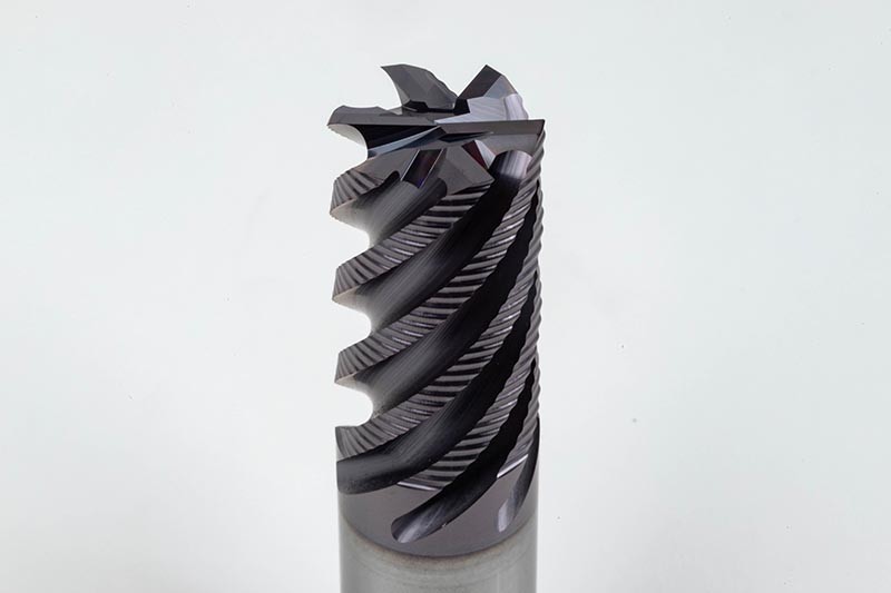

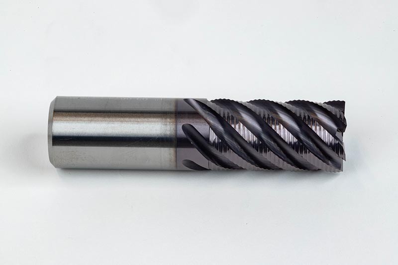

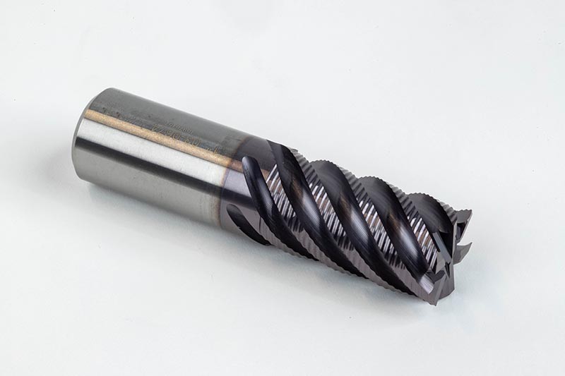

1" Dia. Carbide Fine Roughing End Mill, 6 Flute, TiAlN Coated, 1" Smooth Shank x 1-3/4" LOC, 0.007" Chamfer, FPCHH
Part #: 03-0674
REM 1" HI HELIX 6FL CARB TIALN
Price: 251.95 ( / unit)
226.97
This FPCHH 6-flute carbide roughing end mill has a 1.0 in \ 1" cutting diameter, with a 1" smooth shank, 1-3/4" length of cut (LOC), 0.007" chamfer, and a 4" overall length. It is TiAlN coated, and made to cut steel, stainless steel, and high temp. alloys. This roughing end mill is designed to center-cut.
ISO Material Chart
Haas Milling Series FPCHH
Primary Workpiece Material M - Stainless Steel, S - High Temp Alloys, P - Steel
Material Carbide
Coating TiAlN
Corner Type Chamfer
Shank Type Smooth
[ØDC] Cutting Diameter 1.0 in \ 1"
[ØDMM] Shank Diameter 1.0 in
[LOC] Length Of Cut 1.75 in
[OAL] Overall Length 4.0 in
[NOF] Number of Flutes 6
[CHW\RE] Chamfer \ Radius Size 0.007 in
[FHA°] Helix Angle 45
Cutting Direction Right
Center Cutting Yes
Variable Pitch No
Through Spindle Coolant No
Weight 1.4 lbs \ 0.6 kg
