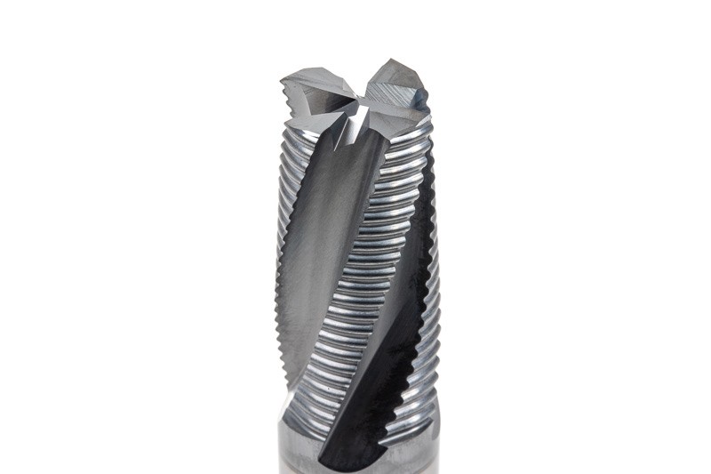

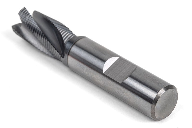

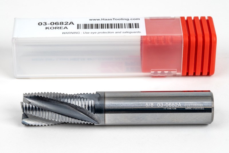

5/8" Dia. Carbide Fine Roughing End Mill, 4 Flute, Hybrid AlCrN Coated, 5/8" Weldon Shank x 1-1/4" LOC, 0.024" Chamfer, FPCLH
Part #: 03-0682A
REM 5/8" LOW HELIX 4FL CARB ALCRN WF
Price: 110.95 ( / unit)
88.97
This FPCLH 4-flute carbide roughing end mill has a 0.625 in \ 5/8" cutting diameter, with a 5/8" weldon shank, 1-1/4" length of cut (LOC), 0.024" chamfer, and a 3-1/2" overall length. It is hybrid AlCrN coated, and made to cut steel and hardened metals. This roughing end mill is designed to center-cut.
ISO Material Chart
Haas Milling Series FPCLH
Primary Workpiece Material P - Steel, H - Hardened Steels
Material Carbide
Coating Hybrid AlCrN
Corner Type Chamfer
Shank Type Weldon
[ØDC] Cutting Diameter 0.625 in \ 5/8"
[ØDMM] Shank Diameter 0.625 in
[LOC] Length Of Cut 1.25 in
[OAL] Overall Length 3.5 in
[NOF] Number of Flutes 4
[CHW\RE] Chamfer \ Radius Size 0.024 in
[FHA°] Helix Angle 20
Cutting Direction Right
Center Cutting Yes
Variable Pitch No
Through Spindle Coolant No
Weight 0.5 lbs \ 0.2 kg
