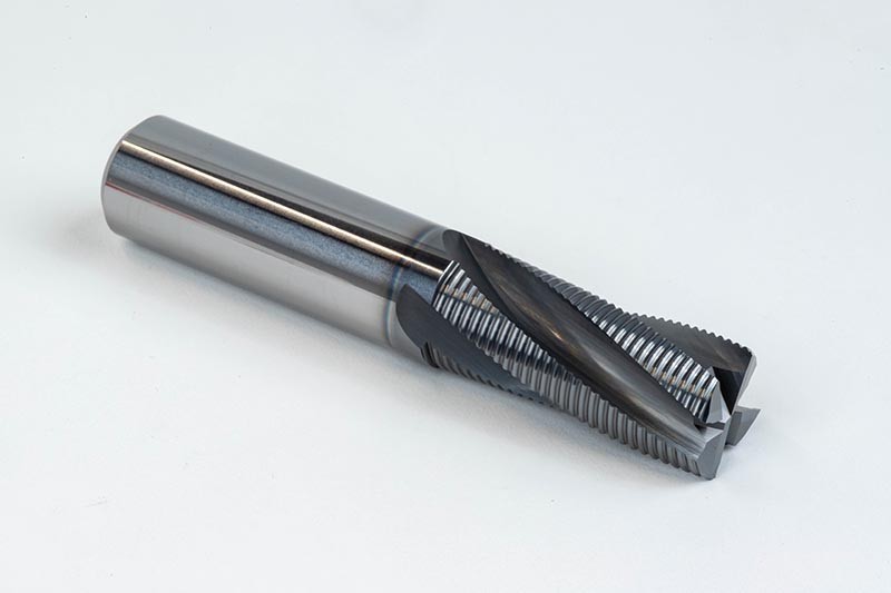

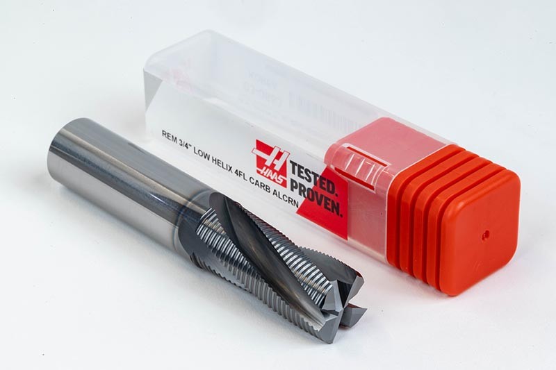

3/4" Dia. Carbide Fine Roughing End Mill, 4 Flute, Hyb. AlCrN Coated, 3/4" Smooth Shank x 1-5/8" LOC, 0.024" Chamfer, FPCLH
Part #: 03-0683
REM 3/4" LOW HELIX 4FL CARB ALCRN
Price: 157.95 ( / unit)
126.97
This FPCLH 4-flute carbide roughing end mill has a 0.75 in \ 3/4" cutting diameter, with a 3/4" smooth shank, 1-5/8" length of cut (LOC), 0.024" chamfer, and a 4" overall length. It is hybrid AlCrN coated, and made to cut steel and hardened metals. This roughing end mill is designed to center-cut.
ISO Material Chart
Haas Milling Series FPCLH
Primary Workpiece Material P - Steel, H - Hardened Steels
Material Carbide
Coating Hybrid AlCrN
Corner Type Chamfer
Shank Type Smooth
[ØDC] Cutting Diameter 0.75 in \ 3/4"
[ØDMM] Shank Diameter 0.75 in
[LOC] Length Of Cut 1.625 in
[OAL] Overall Length 4.0 in
[NOF] Number of Flutes 4
[CHW\RE] Chamfer \ Radius Size 0.024 in
[FHA°] Helix Angle 20
Cutting Direction Right
Center Cutting Yes
Variable Pitch No
Through Spindle Coolant No
Weight 0.8 lbs \ 0.4 kg
