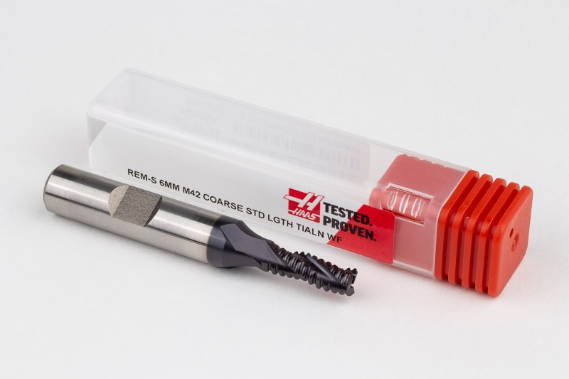

6mm Dia. Cobalt Coarse Roughing End Mill, 3 Flute, TiAIN Coated, 10mm Weldon Shank x 16mm LOC, 0.25mm Chamfer, CPR
Part #: 03-1759
REM-S 6MM M42 COARSE STD LGTH TIALN WF
Price: 19.95 ( / unit)
Price: 323.95 ( / unit)
Price: 96.95 ( / unit)
Price: 12.95 ( / unit)
Price: 58.95 ( / unit)
Price: 135.95 ( / unit)
18.97

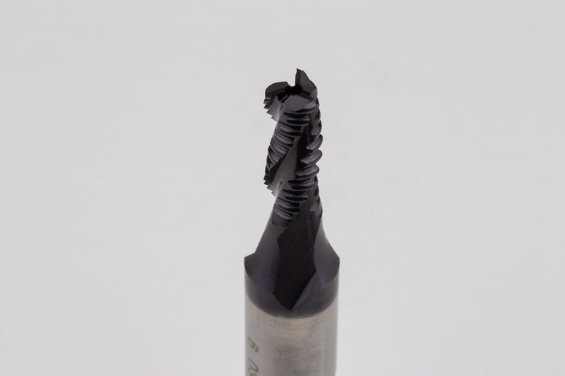

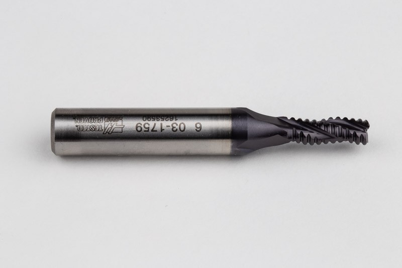

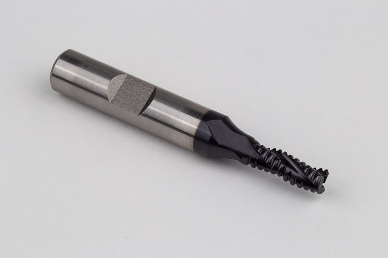

This CPR 3-flute HSSCo8 (M42) cobalt roughing end mill has a 6mm cutting diameter, with a 10mm weldon shank, 16mm length of cut (LOC), 0.25mm chamfer, and a 65mm overall length. It is TiAlN coated, and made to cut steel, but is capable of cutting some grades of aluminum/non-ferrous materials. This roughing end mill is NOT designed to center-cut.
  • SPEEDS & FEEDS (SIDE CUTTING)
  • SPEEDS & FEEDS (SLOTTING)
ISO Material Chart
Haas Milling Series CPR
Secondary Workpiece Material N - Aluminum
Material HSSCo8 (M42)
Coating TiAlN
Corner Type Chamfer
Shank Type Weldon
[ØDC] Cutting Diameter 6.0 mm
[ØDMM] Shank Diameter 10.0 mm
[LOC] Length Of Cut 16.0 mm
[OAL] Overall Length 65.0 mm
[NOF] Number of Flutes 3
[CHW\RE] Chamfer \ Radius Size 0.25 mm
[FHA°] Helix Angle 30
Cutting Direction Right
Center Cutting No
Variable Pitch No
Through Spindle Coolant No
