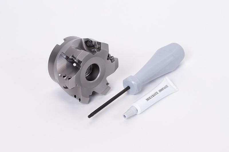

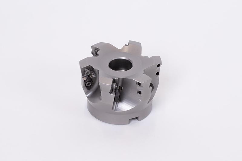

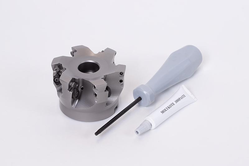

HSHF, 3" Ø Shell Mill, 1" Pilot Bore x 15° Lead Angle, 6 Flute, High Feed, TSC
Part #: 01-0018
HSHF-3.0-1.0-4-6C SHELL MILL
Price: 186.95 ( / unit)
168.97
This Haas Square High Feed (HSHF) medium-pitch shell mill is a superb choice for high-feed milling applications due to its unique, d ouble-clamp design. Its construction offers much greater stability for faster, lighter cuts, and is applicable for various toolpath types, including axial plunge milling, copy milling, face milling, helical milling, ramping, and slotting. It has a 3.0 in \ 3" cutting diameter, and a 1" pilot bore, with a 15-degree cutting edge. The positive axial, negative radial-raked cutter body takes 6 square cutting inserts. The double-clamp inserts have 4 cutting edges, and are available in grades for steel and stainless steel. This cutter body is through-tool coolant (TSC) capable, when used in conjunction with a coolant-through arbor screw. Inserts and coolant-through arbor screw sold separately.

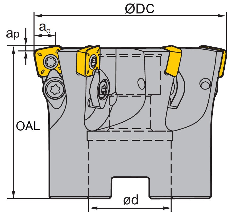

[ØDC] Cutting Diameter 3.0 in \ 3"
Milling Cutter Series HSHF - Haas Square Hi Feed
Toolpath Type Face Milling, Ramping, Helical Milling, Axial Plunge Milling, Copy Milling, Slotting
[°] Lead Angle 15 Degree
[Z] Number of Cutting Teeth 6
[Ød] Arbor Hole Diameter 1.0 in
[a] Keyway Width 0.375 in
[Ap] Max. Cutting Depth 0.071 in
[OAL] Overall Length 2.0 in
Maximum RPM 4100
Torque of Insert Screw 340 Ncm
Coupling Style A
Through Tool Coolant Yes
Weight 3.0 lbs \ 1.4 kg
