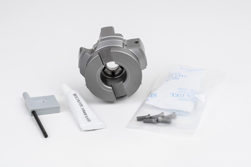

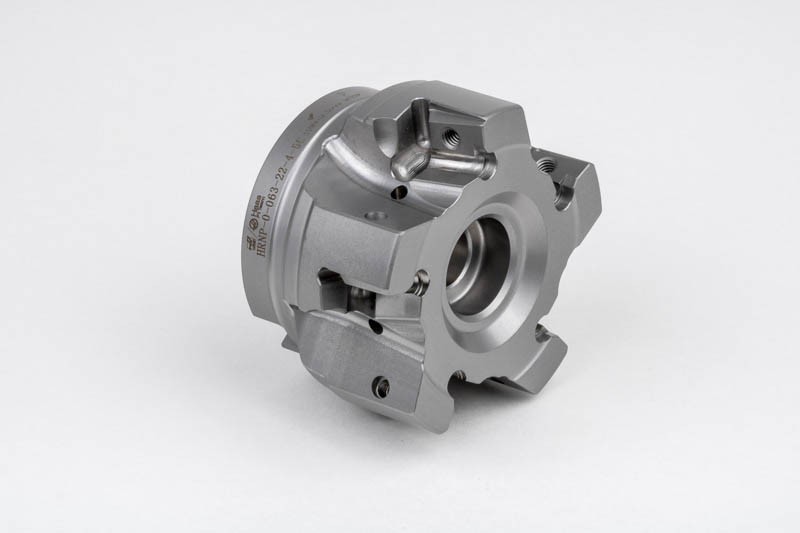

This Haas Rectangle Negative Positive (HRNP) medium-pitch shell mill is a robust milling cutter that excels in many roughing applications, for a wide range of materials. The double-sided, thick rectangular inserts allow for greater cutting stability and deeper cutting depths when face milling and shoulder milling. It has a 63mm cutting diameter, and a 22mm pilot bore, with a 90-degree cutting edge. The negative axial, positive radial-raked cutter body takes 5 parallelogram cutting inserts. The screw-clamp inserts have 4 cutting edges, and are available in grades for steel, stainless steel, cast iron, and aluminum/non-ferrous materials. This cutter body is through-tool coolant (TSC) capable, when used in conjunction with a coolant-through arbor screw. Inserts and coolant-through arbor screw sold separately.
PLEASE NOTE: Our HPNP bodies and inserts are identical to our HRNP bodies and inserts.
  • Speeds and Feeds
[ØDC] Cutting Diameter 63.0 mm
Milling Cutter Series HRNP - Haas Rectangle - / +
Toolpath Type Shoulder Milling, Face Milling
[°] Lead Angle 90 Degree
[Z] Number of Cutting Teeth 5
[Ød] Arbor Hole Diameter 22.0 mm
[a] Keyway Width 10.4 mm
[Ap] Max. Cutting Depth 14.5 mm
[OAL] Overall Length 40.0 mm
Maximum RPM 1800
Torque of Insert Screw 340 Ncm
Coupling Style A
Through Tool Coolant Yes
Weight 1.2 lbs \ 0.6 kg
