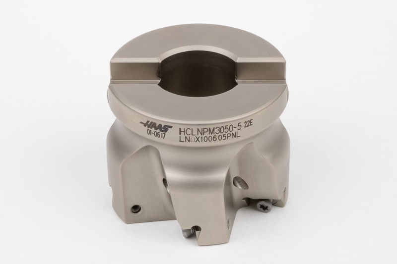

HLNP, 50mm Ø Shell Mill, 22mm Pilot Bore x 90° Lead Angle, 5 Flute, Negative/Positive Geometry, TSC
Part #: 01-0617
HCLNPM3050-5
Price: 325.95 ( / unit)
Price: 4098.95 ( / unit)
Price: 1219.95 ( / unit)
Price: 163.95 ( / unit)
Price: 737.95 ( / unit)
Price: 1721.95 ( / unit)
277.97
This Haas Rectangle Negative Positive (HLNP) medium-pitch shell mill is an excellent choice for high productivity, vertical roughing applications. The wide pockets allow for much greater chip evacuation, and the negative axial cutter orientation, paired with the high-rake insert edges provide a strong cutting edge for larger cutting depths, while still maintaining good machinability. These features improve overall performance when axial plunge milling, face milling, helical milling, shoulder milling, and slotting. It has a 50mm cutting diameter, and a 22mm pilot bore, with a 90-degree cutting edge. The negative axial, positive radial-raked cutter body takes 5 rectangle cutting inserts. The screw-clamp inserts have 4 cutting edges, and are available in grades for steel, stainless steel, and cast iron. This cutter body is through-tool coolant (TSC) capable, when used in conjunction with a coolant-through arbor screw. Inserts and coolant-through arbor screw sold separately.
  • Speeds and Feeds
[ØDC] Cutting Diameter 50.0 mm
Milling Cutter Series HLNP - Rectangular - / +
Toolpath Type Slotting, Helical Milling, Face Milling, Shoulder Milling, Axial Plunge Milling
[°] Lead Angle 90 Degree
[Z] Number of Cutting Teeth 5
[Ød2] Diameter 47.0 mm
[Ød] Arbor Hole Diameter 22.0 mm
[a] Keyway Width 10.4 mm
[b] Keyway Depth 6.3 mm
[Ap] Max. Cutting Depth 1.5 mm
[OAL] Overall Length 40.0 mm
Maximum RPM 13000
Torque of Insert Screw 300 Ncm
Coupling Style B
Through Tool Coolant Yes
Weight 0.7 lbs \ 0.3 kg
