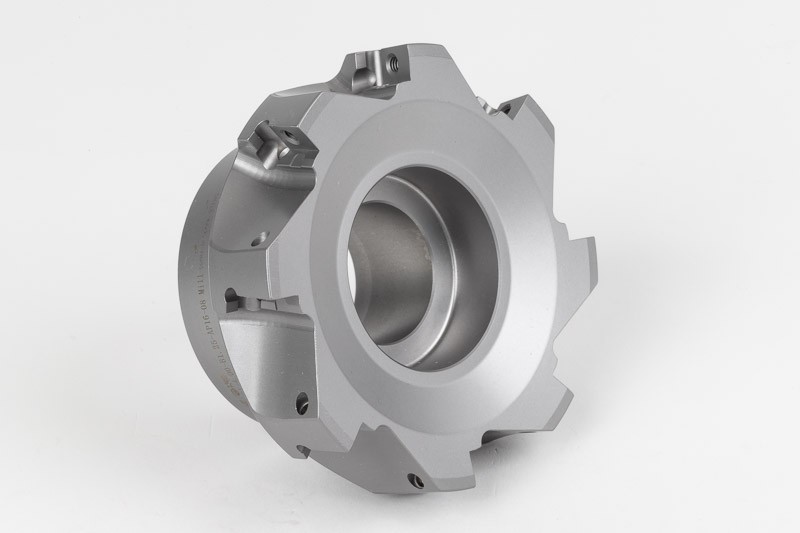

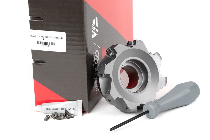

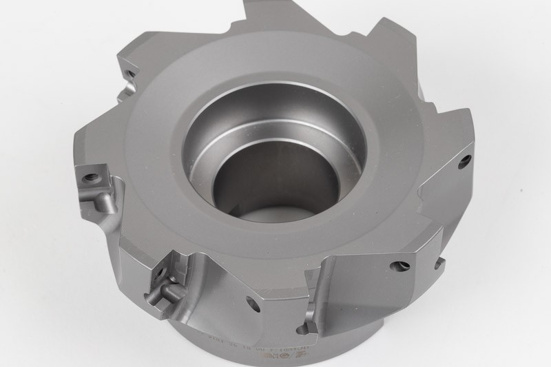

HAPN, 4" Ø Shell Mill, 1-1/4" Pilot Bore x 90° Lead Angle, 8 Flute, Positive/Negative Geometry
Part #: 01-0642
HCAPNI-4.00-B1.25-AP16-08
Price: 194.95 ( / unit)
165.97
This Haas Parallelogram Positive/Negative (HAPN) fine-pitch shell mill is characterized by its axially positive, soft-cutting insert geometry and wide chip pockets, which respectively, improve machinability and chip evacuation at large cutting depths, particularly when face milling and shoulder milling. It has a 4.0 in \ 4" cutting diameter, and a 1-1/4" pilot bore, with a 90-degree cutting edge. The positive axial, negative radial-raked cutter body takes 8 parallelogram cutting inserts. The screw-clamp inserts have 2 cutting edges, and are available in grades for steel, stainless steel, and aluminum/non-ferrous materials. Inserts sold separately.

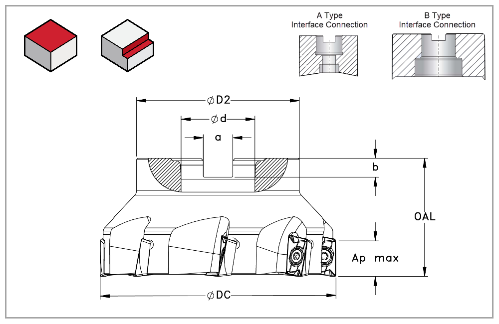

[ØDC] Cutting Diameter 4.0 in \ 4"
Milling Cutter Series HAPN – Haas Parallelogram +/-
Toolpath Type Shoulder Milling, Face Milling
[°] Lead Angle 90 Degree
[Z] Number of Cutting Teeth 8
[Ød2] Diameter 2.76 in
[Ød] Arbor Hole Diameter 1.25 in
[a] Keyway Width 0.5 in
[b] Keyway Depth 0.319 in
[Ap] Max. Cutting Depth 0.63 in
[OAL] Overall Length 2.0 in
Maximum RPM 12500
Torque of Insert Screw 340 Ncm
Coupling Style B
Through Tool Coolant No
Weight 4.4 lbs \ 2.0 kg
