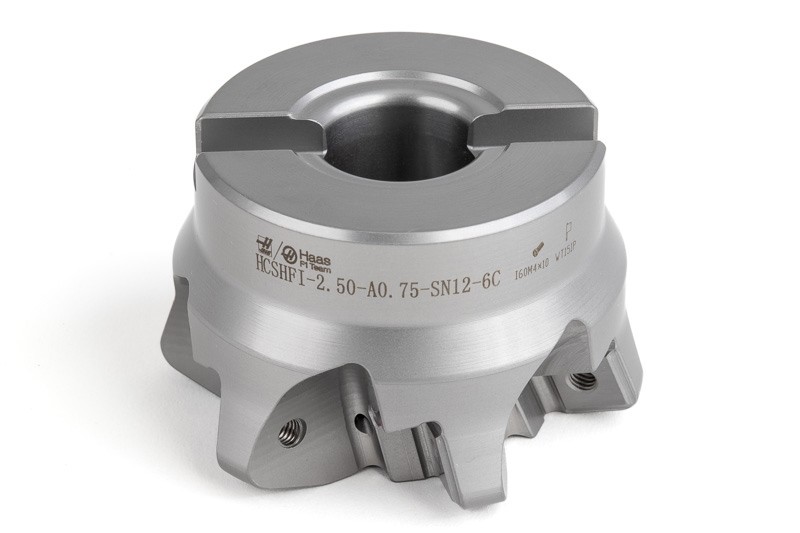

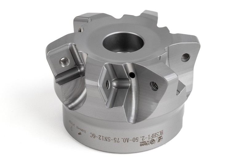

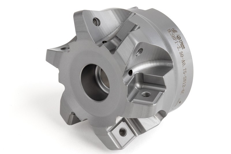

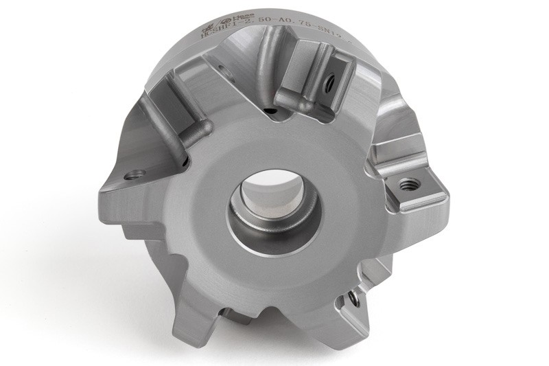

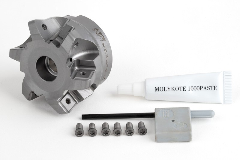

HCSHF, 2-1/2" Ø Shell Mill, 3/4" Pilot Bore x 17° Lead Angle, 6 Flute, High Feed, TSC
Part #: 01-0720
HCSHFI-2.50-A0.75-SN12-6C
Price: 346.95 ( / unit)
294.97
This Haas Double Square High Feed (HCSHF) medium-pitch shell mill is an economical, large-rake cutter with great vibration damping properties. The impact-resistant geometry allows for incredibly stable high-feed machining when axial plunge milling, copy milling, face milling, helical milling, and ramping. It has a 2.5 in \ 2-1/2" cutting diameter, and a 3/4" pilot bore, with a 17-degree cutting edge. The negative axial, negative radial-raked cutter body takes 6 square cutting inserts. The screw-clamp inserts have 8 cutting edges, and are available in grades for steel and stainless steel. This cutter body is through-tool coolant (TSC) capable, when used in conjunction with a coolant-through arbor screw. Inserts and coolant-through arbor screw sold separately.
[ØDC] Cutting Diameter 2.5 in \ 2-1/2"
Milling Cutter Series HCSHF - Haas Double Sq Hi Feed
Toolpath Type Copy Milling, Axial Plunge Milling, Face Milling, Helical Milling, Ramping
[ØDCN] Min. Cutting Diameter 1.728 in
[°] Lead Angle 17 Degree
[Z] Number of Cutting Teeth 6
[Ød] Arbor Hole Diameter 0.75 in
[E] Arbor Hole Depth 0.669 in
[a] Keyway Width 0.313 in
[b] Keyway Depth 0.2205 in
[Ap] Max. Cutting Depth 0.07 in
[OAL] Overall Length 1.575 in
Maximum RPM 5000
Torque of Insert Screw 340 Ncm
Coupling Style A
Through Tool Coolant Yes
Weight 1.58 lbs \ 0.72 kg
