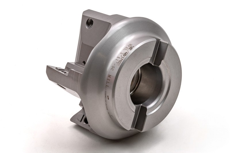

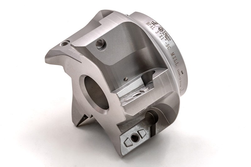

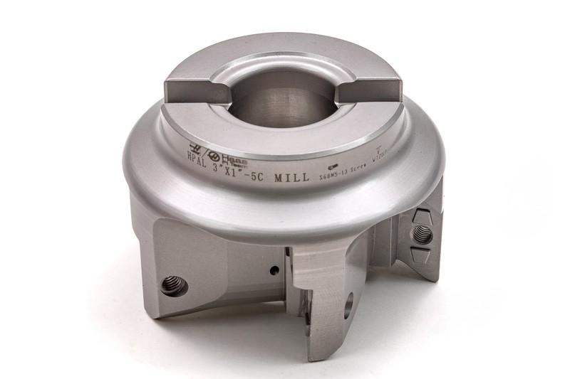

HPAL2, 3" Ø Shell Mill, 1" Pilot Bore x 90° Lead Angle, 5 Flute, Positive/Positive Geometry, TSC
Part #: 01-0781
HPAL 3" x 1"-5C SHELL MILL
Price: 314.95 ( / unit)
283.97
This Haas High Positive Aluminum (HPAL2) medium-pitch shell mill is specially designed for heavy machining of aluminum and similar n on-ferrous materials, while maintaining a good surface finish. The concave grooves found on the back of its inserts provide for strong clamping at higher cutting speeds, and the buffed cutting surfaces ensure smoother chip evacuation and reduced built-up edge (BUE) when copy milling, face milling, helical milling, ramping, shoulder milling, and slotting. It has a 3.0 in \ 3" cutting diameter, and a 1" pilot bore, with a 90-degree cutting edge. The positive axial, positive radial-raked cutter body takes 5 polygon/special cutting inserts. The screw-clamp inserts have 2 cutting edges, and are available in grades for aluminum/non-ferrous materials. This cutter body is through-tool coolant (TSC) capable, when used in conjunction with a coolant-through arbor screw. Inserts and coolant-through arbor screw sold separately.
[ØDC] Cutting Diameter 3.0 in \ 3"
Milling Cutter Series HPAL2 - Haas HP Aluminum
Toolpath Type Ramping, Slotting, Shoulder Milling, Copy Milling, Face Milling, Helical Milling
[°] Lead Angle 90 Degree
[Z] Number of Cutting Teeth 5
[Ød] Arbor Hole Diameter 1.0 in
[a] Keyway Width 0.375 in
[Ap] Max. Cutting Depth 0.862 in
[OAL] Overall Length 2.0 in
[IC] Inscribed Circle Diameter 0.502 in \ 12.76 mm
[L10] Cutting Edge Length 0.862 in \ 21.9 mm
Maximum RPM 5800
Torque of Insert Screw 1020 Ncm
Coupling Style A
Through Tool Coolant Yes
Weight 0.9 lbs \ 0.4 kg
