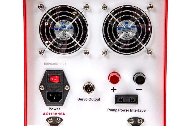

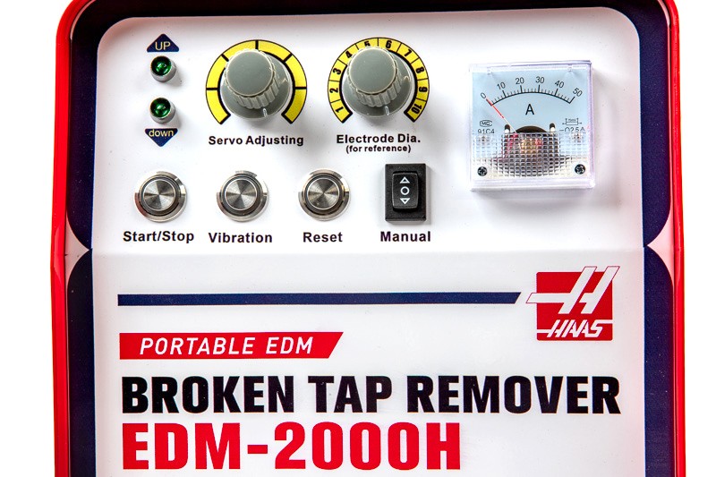

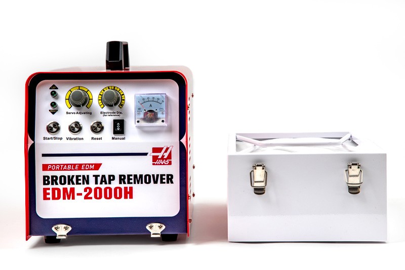

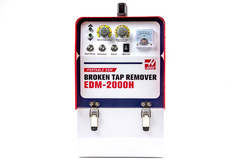

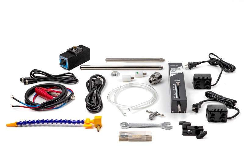

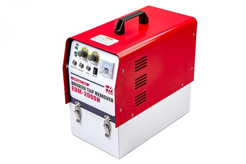

The Haas EDM-2000H is a high-powered electrical discharge machine (EDM) designed for the removal of broken taps, drills, reamers, screws, plug gauges, and other metallic obstructions, without damaging the workpiece. It is suitable for components of diverse sizes, and is particularly effective for large machine parts, where traditional removal methods may be impractical or risk further damage.
This machine features a split-structure design, consisting of a separate chassis and storage box, which enhances operational flexibility, accessibility, and convenience.
Product Highlights:
____________________________
  • Compact and portable – ideal for moving between workstations or job sites.
  • Non-destructive process – does not damage original workpiece.
  • Adjustable work head – work head can mount on any magnetic surface, and rotate in multiple directions to access complex geometries.
  • Stainless steel chuck – able to clamp 1 to 10 mm electrodes.
  • Two modes for working fluid delivery – through the electrode chuck or using the flexible hose with magnetic base.
  • Auto retracting work head – work head will auto retract after the depth locking screw reaches zero.
  • Capable of removing taps from M2 to M30 (5/64" – 1-3/16")
  • Vibration mode – perfect for removing taps faster from non-critical holes.
  • Brass electrodes
    • Round Electrodes: 1 to 5 mm (0.039" - 0.197")
    • Sheet Electrodes: 10 mm x 2 mm (0.394" x 0.079")

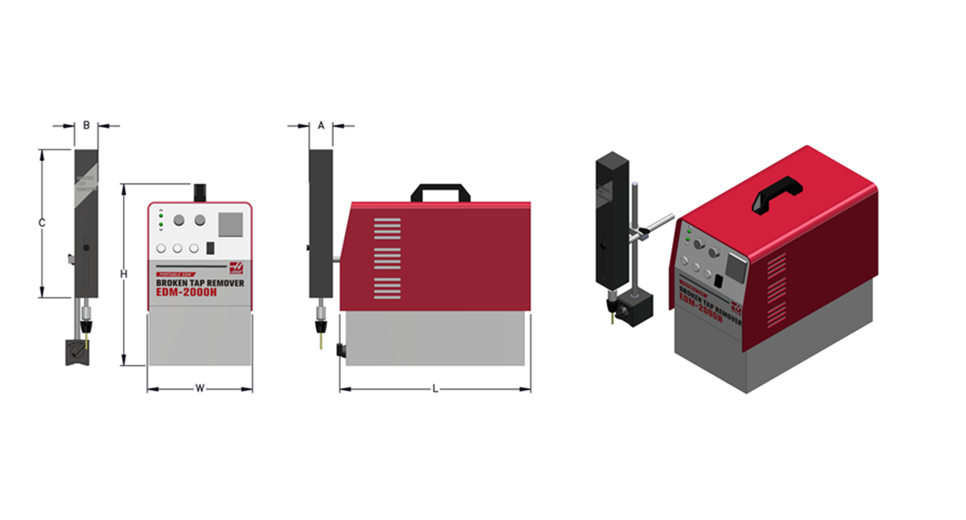

Dimensions S.A.E METRIC
Power Box Length (L) 15.94 in 405.0 mm
Power Box Width (W) 8.66 in 220.0 mm
Power Box Height (H) 14.56 in 370.0 mm
Work Head Length (A) 1.96 in 315.0 mm
Work Head Width (B) 1.96 in 50.0 mm
Work Head Height (C) 12.40 in 50.0 mm
Packaging Size 20.78 in x 12.71 in x 18.50 in 528.0 mm x 323.0 mm x 470.0 mm
