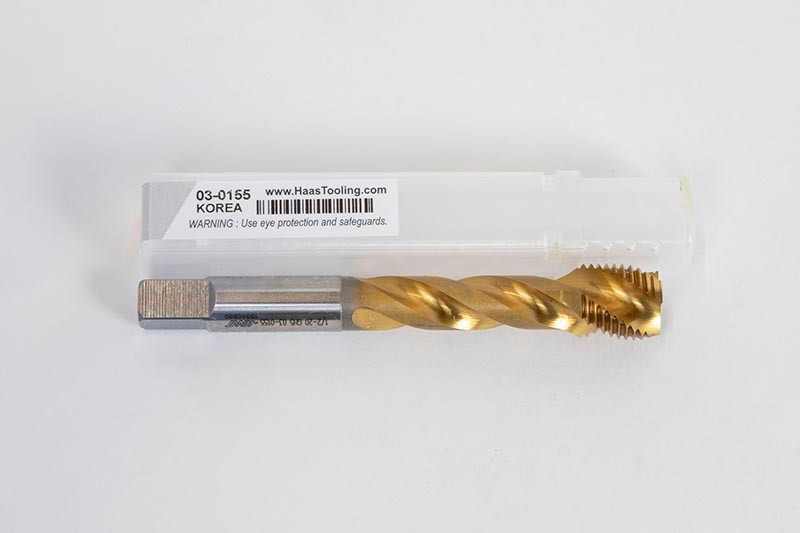

1/2"-20 UNF HSS-E Spiral Flute Tap, 0.367" Shank x 0.472" Thread Length, 2.5XD, Mod. Bottoming, 3 Flute, GH5, TiN Coated
Part #: 03-0155
1/2-20 SP FL TSC MULTIPLE MATERIAL TAP
Price: 34.95 ( / unit)
22.97
ISO MATERIAL CHART
Thread Series UNF - Unified Natl. Fine
Thread Size 1/2"-20
Primary Workpiece Material K - Cast Iron, N - Aluminum, M - Stainless Steel, P - Steel
Tap Type Spiral Flute
Shank Type Square
Material HSS-E
Coating TiN
[TPI] Threads per Inch 20 tpi
Tap Drill Diameter 0.453 in
[ØDC] Cutting Diameter 0.5 in
[ØDMM] Shank Diameter 0.367 in
[L2] Chamfer Length 2P - 3P
[L1] Thread Length 0.472 in
[LU] Usable Length 2.067 in
[OAL] Overall Length 3.374 in
[SS] Square Size 0.275 in
[NOF] Number of Flutes 3
[FHA°] Helix Angle 40
Length / Diameter 2.5 X D
Thread Class GH5
Through Spindle Coolant Yes
