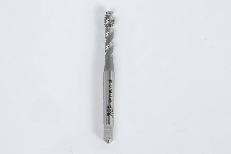

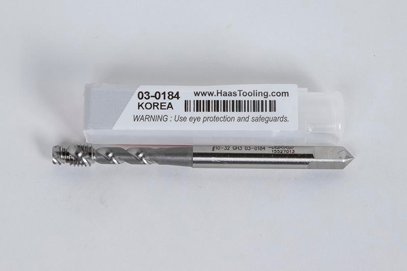

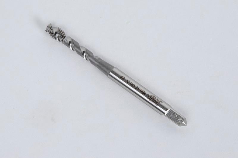

#10-32 UNF HSS-E Spiral Flute Tap, 0.194" Shank x 0.276" Thread Length, 2.5XD, Mod. Bottoming, 2 Flute, GH3, Uncoated
Part #: 03-0184
10-32 SP FL ALUMINUM TAP
Price: 10.95 ( / unit)
6.97
ISO MATERIAL CHART
Thread Series UNF - Unified Natl. Fine
Thread Size #10-32
Tap Type Spiral Flute
Shank Type Square
Material HSS-E
Coating Uncoated
[TPI] Threads per Inch 32 tpi
Tap Drill Diameter 0.161 in
[ØDC] Cutting Diameter 0.19 in
[ØDMM] Shank Diameter 0.194 in
[L2] Chamfer Length 2P - 3P
[L1] Thread Length 0.276 in
[LU] Usable Length 0.906 in
[OAL] Overall Length 2.374 in
[SS] Square Size 0.152 in
[NOF] Number of Flutes 2
[FHA°] Helix Angle 50
Length / Diameter 2.5 X D
Thread Class GH3
Through Spindle Coolant No
