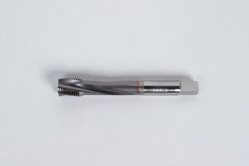

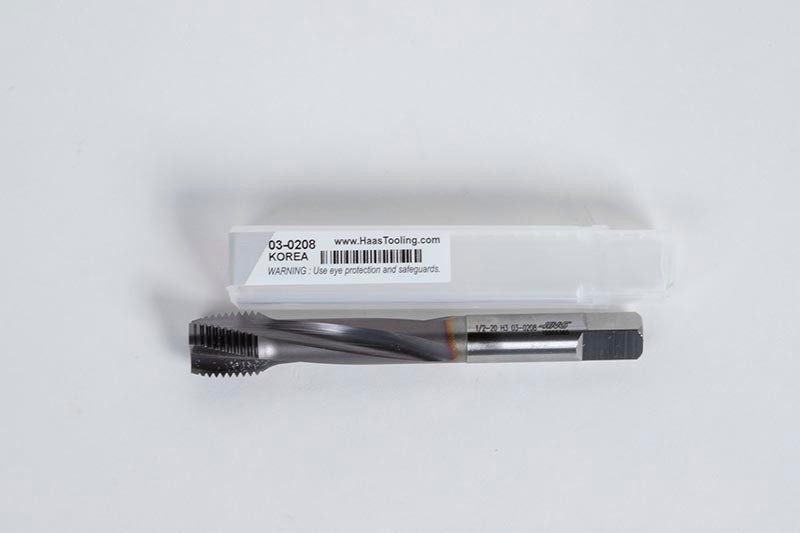

1/2"-20 UNF HSS-E Spiral Flute Tap, 0.367" Shank x 0.472" Thread Length, 2.5XD, Mod. Bottoming, 3 Flute, H3, TiCN Coated
Part #: 03-0208
1/2-20 SP FL TI & NI ALLOY TAP
Price: 36.95 ( / unit)
24.97
This 1/2"-20 UNF (United National Fine) spiral flute tap has a 1/2" thread size, with 20 threads per inch (TPI) and a 0.472" thread length. The 3-flute tap is constructed of high-vanadium high-speed steel (HSS-EX), and designed to cut threads in high-temp alloys. The tap is a modified bottoming type, with an H3 pitch limit, and features a titanium carbonitride (TiCN) coating for improved wear, and resistance to built-up edge.
ISO MATERIAL CHART
Thread Series UNF - Unified Natl. Fine
Thread Size 1/2"-20
Primary Workpiece Material S - High Temp Alloys
Secondary Workpiece Material H - Hardened Materials, P - Steel
Tap Type Spiral Flute
Shank Type Square
Material HSS-E
Coating TiCN
[TPI] Threads per Inch 20 tpi
Tap Drill Diameter 0.453 in
[ØDC] Cutting Diameter 0.5 in
[ØDMM] Shank Diameter 0.367 in
[L2] Chamfer Length 2P - 3P
[L1] Thread Length 0.472 in
[LU] Usable Length 2.067 in
[OAL] Overall Length 3.374 in
[SS] Square Size 0.275 in
[NOF] Number of Flutes 3
[FHA°] Helix Angle 15
Length / Diameter 2.5 X D
Thread Class H3
Through Spindle Coolant No
