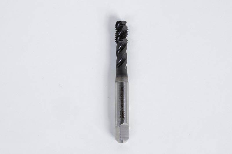

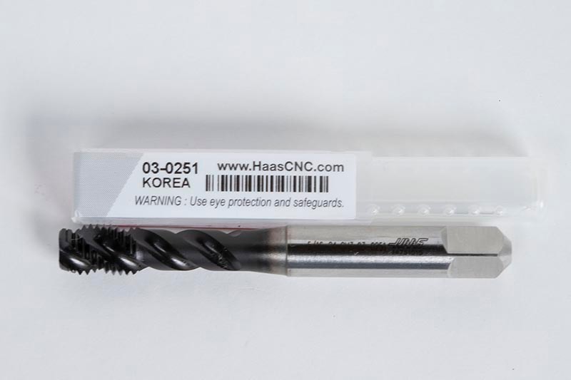

5/16"-24 UNF HSS-E Spiral Flute Tap, 0.318" Shank x 0.394" Thread Length, 2.5XD, Mod. Bottoming, 3 Flute, GH3, Hardslick Coated
Part #: 03-0251
5/16-24 SP Fl STAINLESS TAP
Price: 26.95 ( / unit)
17.97
ISO MATERIAL CHART
Thread Series UNF - Unified Natl. Fine
Thread Size 5/16"-24
Secondary Workpiece Material N - Aluminum
Tap Type Spiral Flute
Shank Type Square
Material HSS-E
Coating Hardslick
[TPI] Threads per Inch 24 tpi
Tap Drill Diameter 0.272 in
[ØDC] Cutting Diameter 0.3125 in
[ØDMM] Shank Diameter 0.318 in
[L2] Chamfer Length 2P - 3P
[L1] Thread Length 0.394 in
[LU] Usable Length 1.126 in
[OAL] Overall Length 2.721 in
[SS] Square Size 0.238 in
[NOF] Number of Flutes 3
[FHA°] Helix Angle 45
Length / Diameter 2.5 X D
Thread Class GH3
