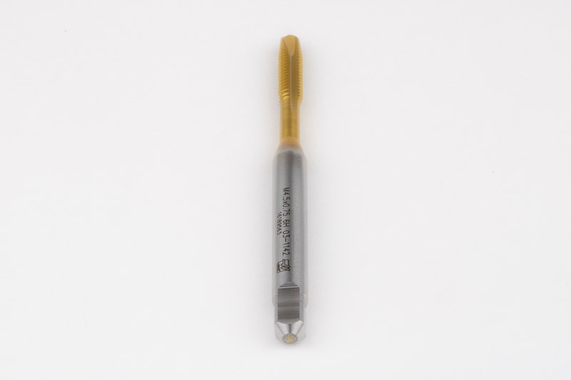

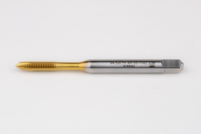

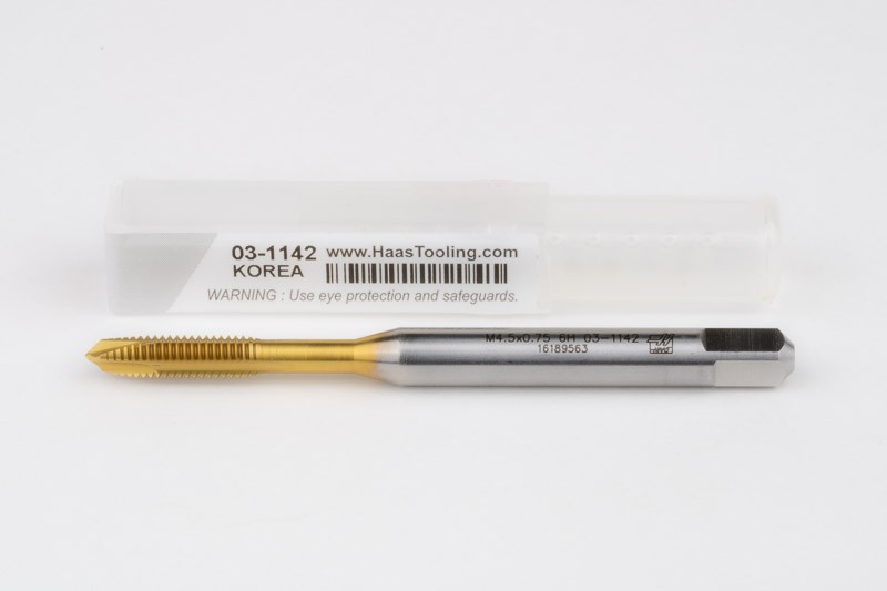

M4.5x0.75 M HSS-E Spiral Point Tap, 6mm Shank x 14mm Thread Length, 3XD, Plug, 3 Flute, 6H, TiN Coated
Part #: 03-1142
M4.5 X 0.75 SP PT MULTIPLE MATERIAL TAP
Price: 11.95 ( / unit)
Price: 173.95 ( / unit)
Price: 51.95 ( / unit)
Price: 6.95 ( / unit)
Price: 31.95 ( / unit)
Price: 72.95 ( / unit)
9.97
  • SPEEDS & FEEDS (INCH)
  • Speeds & Feeds (METRIC)
ISO MATERIAL CHART
Thread Series M - Metric
Thread Size M4.5x0.75
Primary Workpiece Material N - Aluminum, P - Steel, M - Stainless Steel, K - Cast Iron
Tap Type Spiral Point
Chamfer Type Plug
Shank Type Square
Material HSS-E
Coating TiN
[TP] Thread Pitch 0.75 mm
Tap Drill Diameter 3.7 mm
[ØDC] Cutting Diameter 4.5 mm
[ØDMM] Shank Diameter 6.0 mm
[L2] Chamfer Length 4P - 5P
[L1] Thread Length 14.0 mm
[LU] Usable Length 25.0 mm
[OAL] Overall Length 70.0 mm
[SS] Square Size 4.9 mm
[NOF] Number of Flutes 3
[FHA°] Helix Angle 0
Length / Diameter 3 X D
Thread Class 6H
