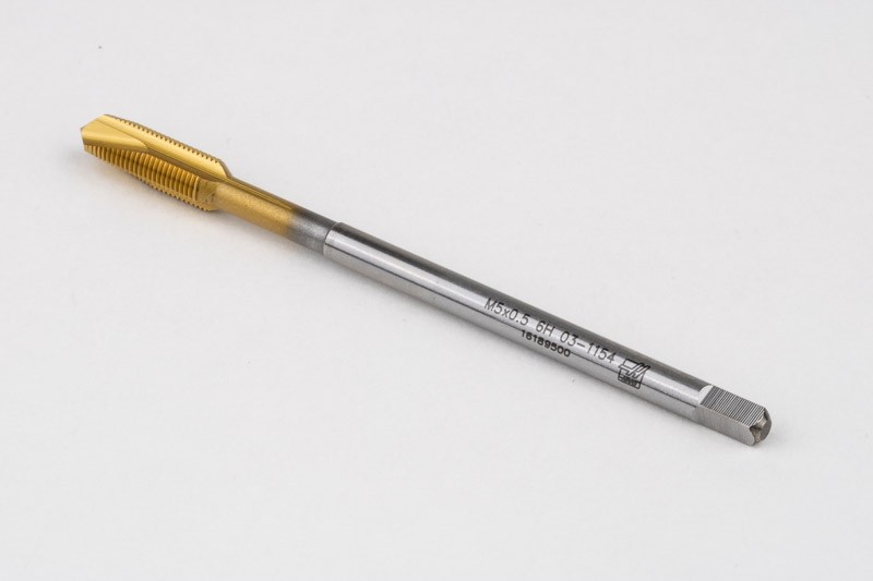

Thread Series MF - Metric Fine
Thread Size M5x0.5
Primary Workpiece Material P - Steel, M - Stainless Steel, K - Cast Iron, N - Aluminum
Tap Type Spiral Point
Chamfer Type Plug
Shank Type Square
Material HSS-E
Coating TiN
[TP] Thread Pitch 0.5 mm
Tap Drill Diameter 4.5 mm
[ØDC] Cutting Diameter 5.0 mm
[ØDMM] Shank Diameter 3.5 mm
[L2] Chamfer Length 4P - 5P
[L1] Thread Length 11.0 mm
[LU] Usable Length 25.0 mm
[OAL] Overall Length 70.0 mm
[SS] Square Size 2.7 mm
[NOF] Number of Flutes 3
[FHA°] Helix Angle 0
Length / Diameter 3 X D
Thread Class 6H
Through Spindle Coolant No
