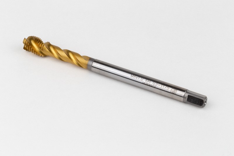

M8x1.0 MF HSS-E Spiral Flute Tap, 6mm Shank x 10mm Thread Length, 2.5XD, Mod. Bottoming, 3 Flute, 6H, TiN Coated
Part #: 03-1175
M8 X 1 SP FL TSC MULTIPLE MATERIAL TAP
Price: 16.95 ( / unit)
Price: 223.95 ( / unit)
Price: 66.95 ( / unit)
Price: 8.95 ( / unit)
Price: 40.95 ( / unit)
Price: 93.95 ( / unit)
12.97
  • SPEEDS & FEEDS (INCH)
  • Speeds & Feeds (METRIC)
ISO MATERIAL CHART
Thread Series MF - Metric Fine
Thread Size M8x1.0
Primary Workpiece Material N - Aluminum, P - Steel, M - Stainless Steel, K - Cast Iron
Tap Type Spiral Flute
Shank Type Square
Material HSS-E
Coating TiN
[TP] Thread Pitch 1.0 mm
Tap Drill Diameter 7.0 mm
[ØDC] Cutting Diameter 8.0 mm
[ØDMM] Shank Diameter 6.0 mm
[L2] Chamfer Length 2P - 3P
[L1] Thread Length 10.0 mm
[LU] Usable Length 36.0 mm
[OAL] Overall Length 90.0 mm
[SS] Square Size 4.9 mm
[NOF] Number of Flutes 3
[FHA°] Helix Angle 40
Length / Diameter 2.5 X D
Thread Class 6H
Through Spindle Coolant Yes
Weight 0.5 lbs \ 0.2 kg
