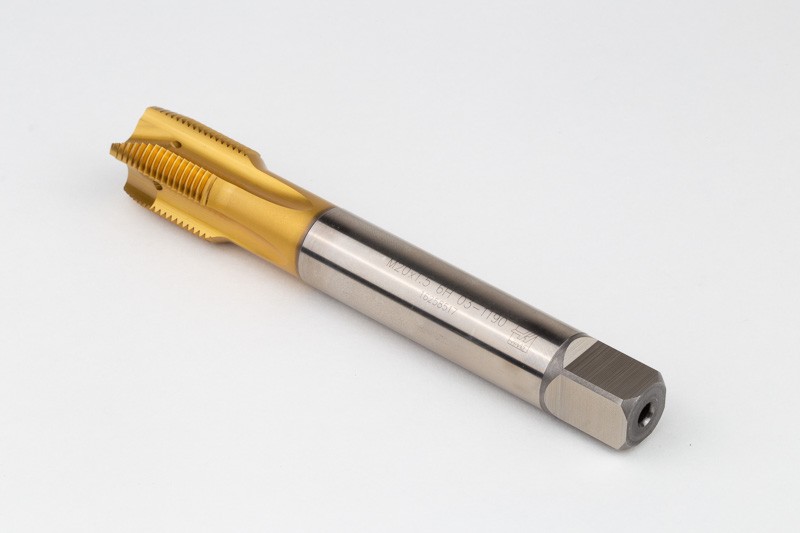

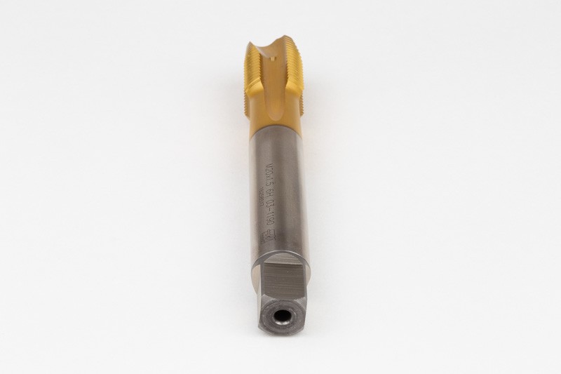

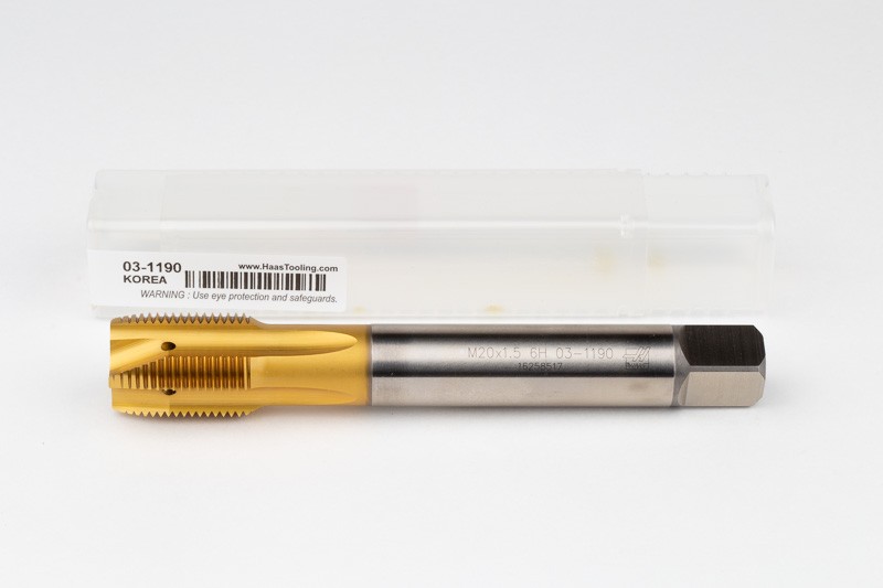

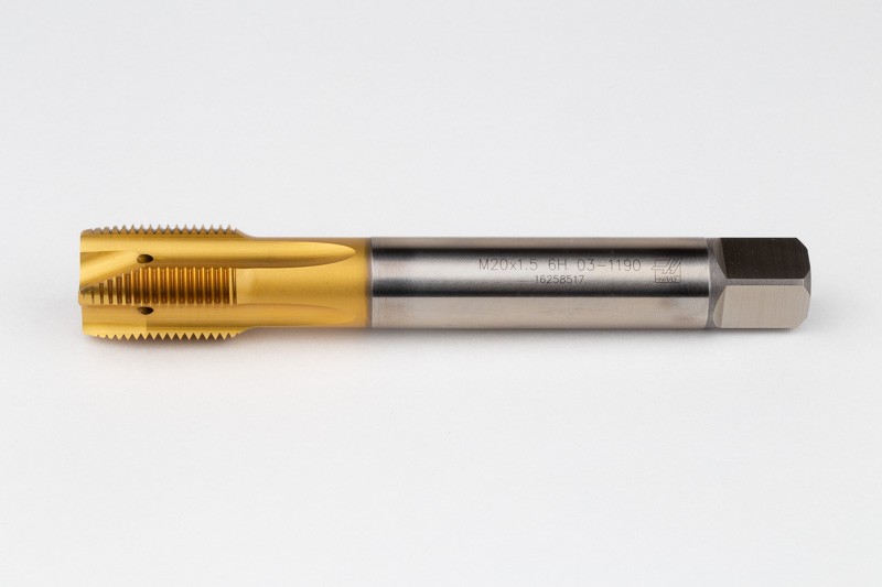

M20x1.5 MF HSS-E Spiral Point Tap, 16mm Shank x 25mm Thread Length, 3XD, Plug, 4 Flute, 6H, TiN Coated
Part #: 03-1190
M20 X 1.5 SP PT TSC MULTIPLE MATERIAL TA
Price: 74.95 ( / unit)
Price: 998.95 ( / unit)
Price: 297.95 ( / unit)
Price: 39.95 ( / unit)
Price: 179.95 ( / unit)
Price: 419.95 ( / unit)
59.97
  • SPEEDS & FEEDS (INCH)
  • Speeds & Feeds (METRIC)
ISO MATERIAL CHART
Thread Series MF - Metric Fine
Thread Size M20x1.5
Primary Workpiece Material N - Aluminum, K - Cast Iron, M - Stainless Steel, P - Steel
Tap Type Spiral Point
Chamfer Type Plug
Shank Type Square
Material HSS-E
Coating TiN
[TP] Thread Pitch 1.5 mm
Tap Drill Diameter 18.5 mm
[ØDC] Cutting Diameter 20.0 mm
[ØDMM] Shank Diameter 16.0 mm
[L2] Chamfer Length 4P - 5P
[L1] Thread Length 25.0 mm
[LU] Usable Length 50.0 mm
[OAL] Overall Length 125.0 mm
[SS] Square Size 12.0 mm
[NOF] Number of Flutes 4
[FHA°] Helix Angle 0
Length / Diameter 3 X D
Thread Class 6H
Through Spindle Coolant Yes
Weight 0.4 lbs \ 0.2 kg
