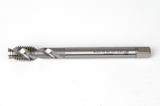

M12x1.75 M HSS-E Spiral Flute Tap, 9mm Shank x 18mm Thread Length, 2.5XD, Mod. Bottoming, 2 Flute, 6H, Uncoated
Part #: 03-1235
M12 X 1.75 SP FL ALUMINUM TAP
Price: $18.95 ( / unit)
Price: 248.95 ( / unit)
Price: 74.95 ( / unit)
Price: 9.95 ( / unit)
Price: 44.95 ( / unit)
Price: 104.95 ( / unit)
$14.97
$14.22 (Save 5%)
  • Speeds & Feeds (METRIC)
ISO MATERIAL CHART
Thread Series M - Metric
Thread Size M12x1.75
Secondary Workpiece Material P - Steel
Tap Type Spiral Flute
Shank Type Square
Material HSS-E
Coating Uncoated
[TP] Thread Pitch 1.75 mm
Tap Drill Diameter 10.2 mm
[ØDC] Cutting Diameter 12.0 mm
[ØDMM] Shank Diameter 9.0 mm
[L2] Chamfer Length 2P - 3P
[L1] Thread Length 18.0 mm
[LU] Usable Length 44.0 mm
[OAL] Overall Length 110.0 mm
[SS] Square Size 7.0 mm
[NOF] Number of Flutes 2
[FHA°] Helix Angle 45
Length / Diameter 2.5 X D
Thread Class 6H
Through Spindle Coolant No
