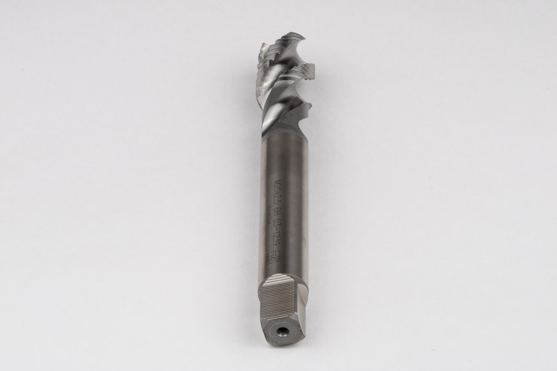

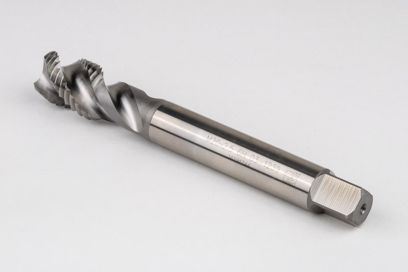

M20x2.5 M HSS-E Spiral Flute Tap, 16mm Shank x 25mm Thread Length, 2.5XD, Mod. Bottoming, 3 Flute, 6H, Uncoated
Part #: 03-1239
M20 X 2.5 SP FL ALUMINUM TAP
Price: 46.95 ( / unit)
Price: 623.95 ( / unit)
Price: 185.95 ( / unit)
Price: 24.95 ( / unit)
Price: 112.95 ( / unit)
Price: 261.95 ( / unit)
37.97
  • Speeds & Feeds (METRIC)
ISO MATERIAL CHART
Thread Series M - Metric
Thread Size M20x2.5
Secondary Workpiece Material P - Steel
Tap Type Spiral Flute
Shank Type Square
Material HSS-E
Coating Uncoated
[TP] Thread Pitch 2.5 mm
Tap Drill Diameter 17.5 mm
[ØDC] Cutting Diameter 20.0 mm
[ØDMM] Shank Diameter 16.0 mm
[L2] Chamfer Length 2P - 3P
[L1] Thread Length 25.0 mm
[LU] Usable Length 54.0 mm
[OAL] Overall Length 140.0 mm
[SS] Square Size 12.0 mm
[NOF] Number of Flutes 3
[FHA°] Helix Angle 45
Length / Diameter 2.5 X D
Thread Class 6H
Through Spindle Coolant No
Weight 0.5 lbs \ 0.2 kg
