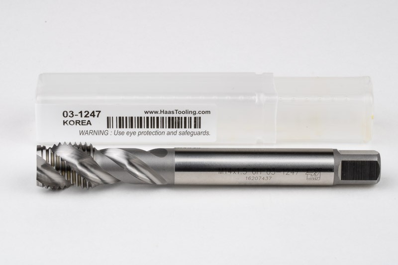

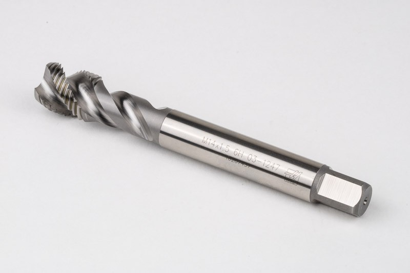

M14x1.5 MF HSS-E Spiral Flute Tap, 11mm Shank x 15mm Thread Length, 2.5XD, Mod. Bottoming, 3 Flute, 6H, Uncoated
Part #: 03-1247
M14 X 1.5 SP FL ALUMINUM TAP
Price: 25.95 ( / unit)
Price: 323.95 ( / unit)
Price: 96.95 ( / unit)
Price: 12.95 ( / unit)
Price: 58.95 ( / unit)
Price: 135.95 ( / unit)
19.97
  • Speeds & Feeds (METRIC)
ISO MATERIAL CHART
Thread Series MF - Metric Fine
Thread Size M14x1.5
Secondary Workpiece Material P - Steel
Tap Type Spiral Flute
Shank Type Square
Material HSS-E
Coating Uncoated
[TP] Thread Pitch 1.5 mm
Tap Drill Diameter 12.5 mm
[ØDC] Cutting Diameter 14.0 mm
[ØDMM] Shank Diameter 11.0 mm
[L2] Chamfer Length 2P - 3P
[L1] Thread Length 15.0 mm
[LU] Usable Length 40.0 mm
[OAL] Overall Length 100.0 mm
[SS] Square Size 9.0 mm
[NOF] Number of Flutes 3
[FHA°] Helix Angle 45
Length / Diameter 2.5 X D
Thread Class 6H
Through Spindle Coolant No
Weight 0.2 lbs \ 0.1 kg
