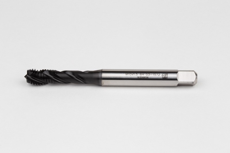

M10x1.5 M HSS-E Spiral Flute Tap, 10mm Shank x 15mm Thread Length, 2.5XD, Mod. Bottoming, 3 Flute, 6H, Hardslick Coated
Part #: 03-1572
M10 X 1.5 TAP SP FL SS HARDSLICK
Price: 22.95 ( / unit)
Price: 298.95 ( / unit)
Price: 88.95 ( / unit)
Price: 11.95 ( / unit)
Price: 53.95 ( / unit)
Price: 125.95 ( / unit)
18.97
  • SPEEDS & FEEDS (INCH)
  • Speeds & Feeds (METRIC)
ISO MATERIAL CHART
Thread Series M - Metric
Thread Size M10x1.5
Tap Type Spiral Flute
Shank Type Square
Material HSS-E
Coating Hardslick
[TP] Thread Pitch 1.5 mm
Tap Drill Diameter 8.5 mm
[ØDC] Cutting Diameter 10.0 mm
[ØDMM] Shank Diameter 10.0 mm
[L2] Chamfer Length 2P - 3P
[L1] Thread Length 15.0 mm
[LU] Usable Length 39.0 mm
[OAL] Overall Length 100.0 mm
[SS] Square Size 8.0 mm
[NOF] Number of Flutes 3
[FHA°] Helix Angle 40
Length / Diameter 2.5 X D
Thread Class 6H
Through Spindle Coolant No
