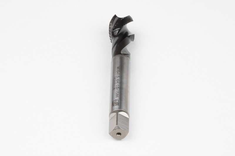

M16x1.5 MF HSS-E Spiral Flute Tap, 12mm Shank x 15mm Thread Length, 2.5XD, Mod. Bottoming, 3 Flute, 6HX, Hardslick Coated
Part #: 03-1586
M16 X 1.5 TAP SP FL SS HARDSLICK
Price: 46.95 ( / unit)
Price: 923.95 ( / unit)
Price: 274.95 ( / unit)
Price: 36.95 ( / unit)
Price: 166.95 ( / unit)
Price: 387.95 ( / unit)
39.97
699.97
208.97
27.97
125.97
293.97
  • SPEEDS & FEEDS (INCH)
  • Speeds & Feeds (METRIC)
ISO MATERIAL CHART
Thread Series MF - Metric Fine
Thread Size M16x1.5
Primary Workpiece Material M - Stainless Steel, P - Steel
Tap Type Spiral Flute
Shank Type Square
Material HSS-E
Coating Hardslick
[TP] Thread Pitch 1.5 mm
Tap Drill Diameter 14.5 mm
[ØDC] Cutting Diameter 16.0 mm
[ØDMM] Shank Diameter 12.0 mm
[L2] Chamfer Length 2P - 3P
[L1] Thread Length 15.0 mm
[LU] Usable Length 40.0 mm
[OAL] Overall Length 100.0 mm
[SS] Square Size 9.0 mm
[NOF] Number of Flutes 3
[FHA°] Helix Angle 40
Length / Diameter 2.5 X D
Thread Class 6HX
Through Spindle Coolant No
Weight 0.2 lbs \ 0.1 kg
