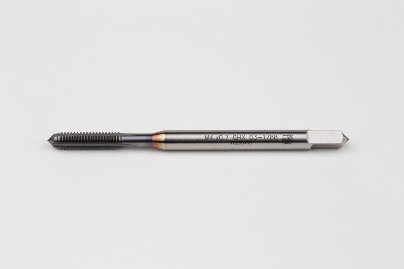

M4x0.7 M HSS-E Straight Flute Tap, 4.5mm Shank x 13mm Thread Length, 2XD, Mod. Bottoming, 3 Flute, 6HX, TiCN Coated
Part #: 03-1788
M4 X 0.7 ST FL CAST IRON TAP
Price: 11.95 ( / unit)
Price: 173.95 ( / unit)
Price: 51.95 ( / unit)
Price: 6.95 ( / unit)
Price: 31.95 ( / unit)
Price: 72.95 ( / unit)
9.97
  • Speeds & Feeds (METRIC)
ISO MATERIAL CHART
Thread Series M - Metric
Thread Size M4x0.7
Primary Workpiece Material K - Cast Iron
Secondary Workpiece Material N - Aluminum
Tap Type Straight Flute
Shank Type Square
Material HSS-E
Coating TiCN
[TP] Thread Pitch 0.7 mm
Tap Drill Diameter 3.3 mm
[ØDC] Cutting Diameter 4.0 mm
[ØDMM] Shank Diameter 4.5 mm
[L2] Chamfer Length 2P - 3P
[L1] Thread Length 13.0 mm
[LU] Usable Length 21.0 mm
[OAL] Overall Length 63.0 mm
[SS] Square Size 3.4 mm
[NOF] Number of Flutes 3
[FHA°] Helix Angle 0
Length / Diameter 2 X D
Thread Class 6HX
Through Spindle Coolant No
