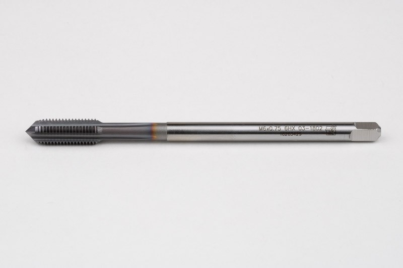

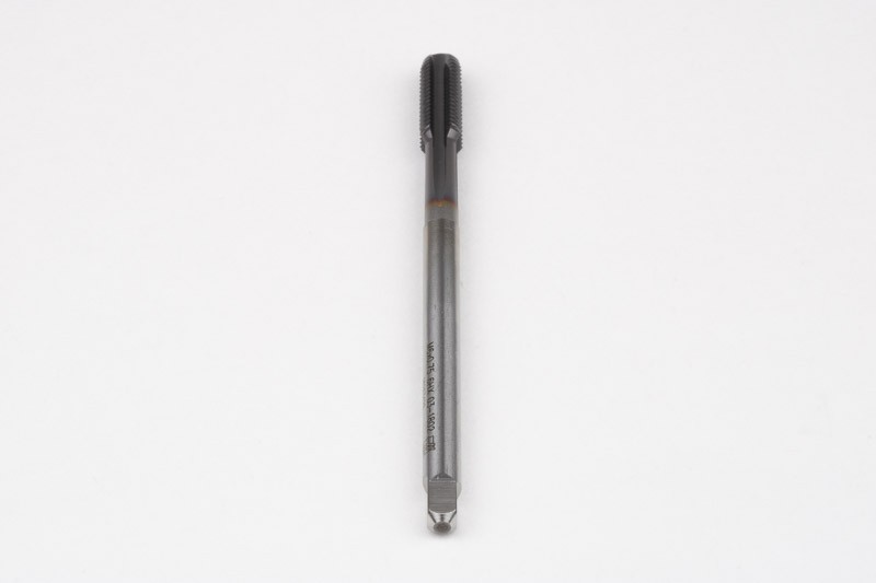

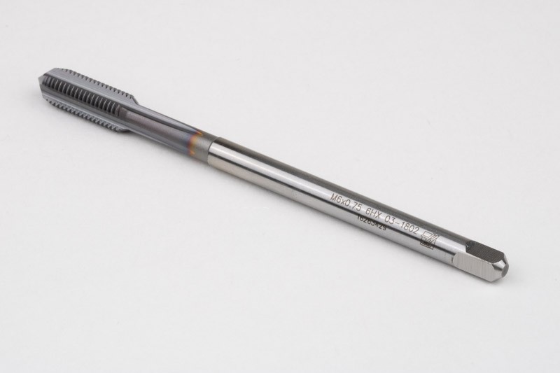

M6x0.75 MF HSS-E Straight Flute Tap, 4.5mm Shank x 13mm Thread Length, 2XD, Mod. Bottoming, 4 Flute, 6HX, TiCN Coated
Part #: 03-1802
M6 X 0.75 ST FL CAST IRON TAP
Price: 14.95 ( / unit)
Price: 198.95 ( / unit)
Price: 59.95 ( / unit)
Price: 7.95 ( / unit)
Price: 35.95 ( / unit)
Price: 83.95 ( / unit)
10.97
  • Speeds & Feeds (METRIC)
ISO MATERIAL CHART
Thread Series MF - Metric Fine
Thread Size M6x0.75
Primary Workpiece Material K - Cast Iron
Secondary Workpiece Material N - Aluminum
Tap Type Straight Flute
Shank Type Square
Material HSS-E
Coating TiCN
[TP] Thread Pitch 0.75 mm
Tap Drill Diameter 5.2 mm
[ØDC] Cutting Diameter 6.0 mm
[ØDMM] Shank Diameter 4.5 mm
[L2] Chamfer Length 2P - 3P
[L1] Thread Length 13.0 mm
[LU] Usable Length 30.0 mm
[OAL] Overall Length 80.0 mm
[SS] Square Size 3.4 mm
[NOF] Number of Flutes 4
[FHA°] Helix Angle 0
Length / Diameter 2 X D
Thread Class 6HX
Through Spindle Coolant No
