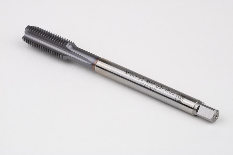

M10x1.25 MF HSS-E Straight Flute Tap, 7mm Shank x 22mm Thread Length, 2XD, Mod. Bottoming, 4 Flute, 6HX, TiCN Coated
Part #: 03-1805
M10 X 1.25 ST FL CAST IRON TAP
Price: 18.95 ( / unit)
Price: 298.95 ( / unit)
Price: 88.95 ( / unit)
Price: 11.95 ( / unit)
Price: 53.95 ( / unit)
Price: 125.95 ( / unit)
15.97
  • Speeds & Feeds (METRIC)
ISO MATERIAL CHART
Thread Series MF - Metric Fine
Thread Size M10x1.25
Primary Workpiece Material K - Cast Iron
Secondary Workpiece Material N - Aluminum
Tap Type Straight Flute
Shank Type Square
Material HSS-E
Coating TiCN
[TP] Thread Pitch 1.25 mm
Tap Drill Diameter 8.8 mm
[ØDC] Cutting Diameter 10.0 mm
[ØDMM] Shank Diameter 7.0 mm
[L2] Chamfer Length 2P - 3P
[L1] Thread Length 22.0 mm
[LU] Usable Length 40.0 mm
[OAL] Overall Length 100.0 mm
[SS] Square Size 5.5 mm
[NOF] Number of Flutes 4
[FHA°] Helix Angle 0
Length / Diameter 2 X D
Thread Class 6HX
Through Spindle Coolant No
