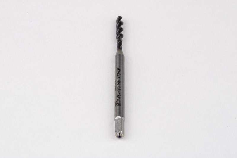

M2x0.4 M HSS-PM Spiral Flute Tap, 2.8mm Shank x 8mm Thread Length, 2.5XD, Mod. Bottoming, 3 Flute, 6H, TiAlN Coated
Part #: 03-1811
M2 X 0.4 SP FL TI & NI ALLOY TAP
Price: 20.95 ( / unit)
Price: 298.95 ( / unit)
Price: 88.95 ( / unit)
Price: 11.95 ( / unit)
Price: 53.95 ( / unit)
Price: 125.95 ( / unit)
16.97
  • SPEEDS & FEEDS (INCH)
  • SPEEDS & FEEDS (METRIC)
ISO MATERIAL CHART
Thread Series M - Metric
Thread Size M2x0.4
Primary Workpiece Material S - High Temp Alloys, P - Steel
Tap Type Spiral Flute
Shank Type Square
Material HSS-PM
Coating TiAlN
[TP] Thread Pitch 0.4 mm
Tap Drill Diameter 1.6 mm
[ØDC] Cutting Diameter 2.0 mm
[ØDMM] Shank Diameter 2.8 mm
[L2] Chamfer Length 2P - 3P
[L1] Thread Length 8.0 mm
[LU] Usable Length 13.0 mm
[OAL] Overall Length 45.0 mm
[SS] Square Size 2.1 mm
[NOF] Number of Flutes 3
[FHA°] Helix Angle 40
Length / Diameter 2.5 X D
Thread Class 6H
