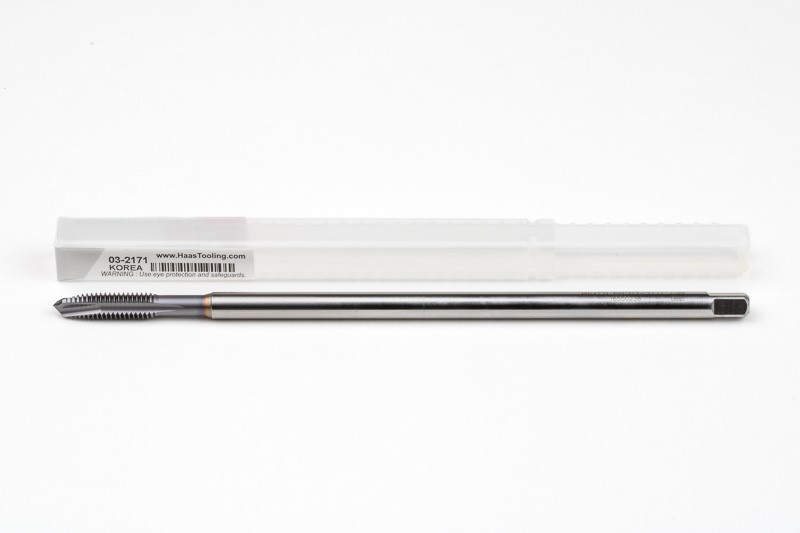

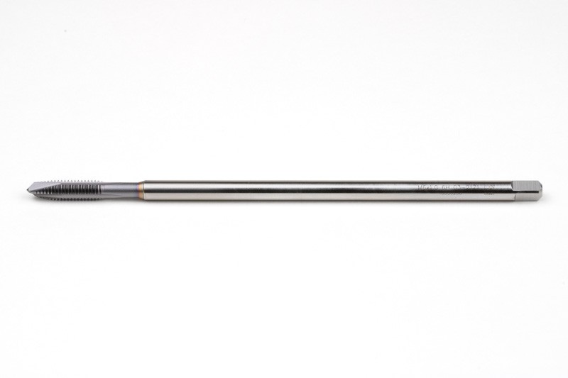

M6x1.0 M HSS-E Spiral Point Ext. Tap, 6mm Shank x 17mm Thread Length, 3XD, Plug, 3 Flute, 6H, TiCN Coated
Part #: 03-2171
M6X1 150MM TAP 6H SP MM TICN
Price: 27.95 ( / unit)
Price: 473.95 ( / unit)
Price: 140.95 ( / unit)
Price: 18.95 ( / unit)
Price: 85.95 ( / unit)
Price: 198.95 ( / unit)
22.97
374.97
111.97
14.97
67.97
157.97
ISO MATERIAL CHART
Thread Series M - Metric
Thread Size M6x1.0
Primary Workpiece Material M - Stainless Steel, N - Aluminum, K - Cast Iron, P - Steel
Tap Type Spiral Point
Chamfer Type Plug
Shank Type Square
Material HSS-E
Coating TiCN
[TP] Thread Pitch 1.0 mm
Tap Drill Diameter 5.0 mm
[ØDC] Cutting Diameter 6.0 mm
[ØDMM] Shank Diameter 6.0 mm
[L2] Chamfer Length 4P - 5P
[L1] Thread Length 17.0 mm
[LU] Usable Length 30.0 mm
[OAL] Overall Length 150.0 mm
[SS] Square Size 4.9 mm
[NOF] Number of Flutes 3
[FHA°] Helix Angle 0
Length / Diameter 3 X D
Thread Class 6H
Through Spindle Coolant No
