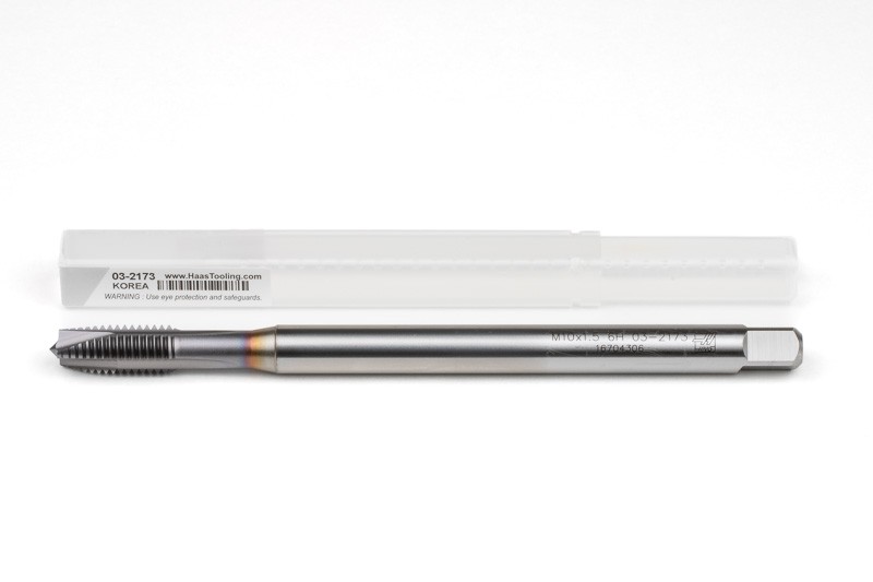

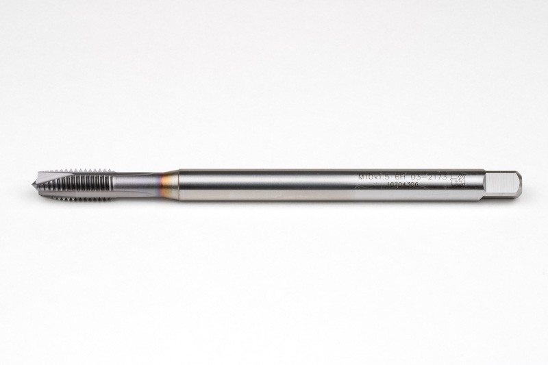

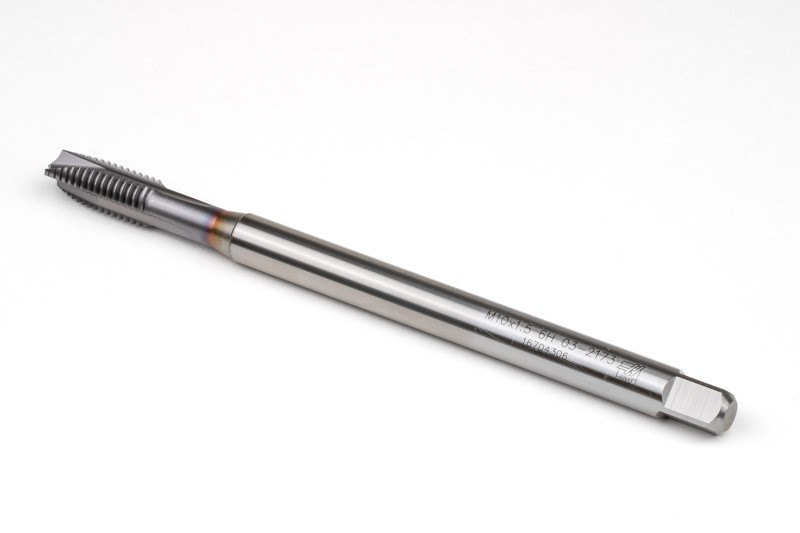

M10x1.5 M HSS-E Spiral Point Ext. Tap, 10mm Shank x 22mm Thread Length, 3XD, Plug, 3 Flute, 6H, TiCN Coated
Part #: 03-2173
M10X1.5 150MM TAP 6H SP MM TICN
Price: 33.95 ( / unit)
Price: 598.95 ( / unit)
Price: 178.95 ( / unit)
Price: 23.95 ( / unit)
Price: 107.95 ( / unit)
Price: 251.95 ( / unit)
27.97
499.97
148.97
19.97
89.97
209.97
ISO MATERIAL CHART
Thread Series M - Metric
Thread Size M10x1.5
Primary Workpiece Material N - Aluminum, K - Cast Iron, P - Steel, M - Stainless Steel
Tap Type Spiral Point
Chamfer Type Plug
Shank Type Square
Material HSS-E
Coating TiCN
[TP] Thread Pitch 1.5 mm
Tap Drill Diameter 8.5 mm
[ØDC] Cutting Diameter 10.0 mm
[ØDMM] Shank Diameter 10.0 mm
[L2] Chamfer Length 4P - 5P
[L1] Thread Length 22.0 mm
[LU] Usable Length 39.0 mm
[OAL] Overall Length 150.0 mm
[SS] Square Size 8.0 mm
[NOF] Number of Flutes 3
[FHA°] Helix Angle 0
Length / Diameter 3 X D
Thread Class 6H
Through Spindle Coolant No
