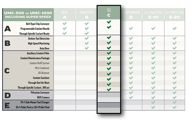

Our Value Option Package-C for UMC-500 through UMC-1000 models (non SS) includes everything in Packages A and B, and adds the auxiliary coolant filter, coolant maintenance package, coolant sanitizer, through-tool air blast, and replaces TSC ready with 300 psi (21 bar) through-spindle coolant.
Package A: Includes a belt-type chip conveyor to efficiently remove chips from the enclosure; and a programmable coolant nozzle to ensure coolant gets where it’s needed.
Package B: Broken tool detection uses a built-in camera to determine if a tool gets damaged during machining. The high-speed machining option enables higher feedrates and more complex toolpaths without hesitation. The auto door reduces operator fatique, and opens the door for future automation.
Package C: The auxiliary coolant filter is a bag-style filtration system that keeps the coolant free of particulates down to 25 microns. The coolant maintenance package keeps your coolant system filled and free of tramp oil, and the coolant sanitizer reduces bacteria and nasty smells. Through-tool air blast and through-spindle coolant deliver high-pressure/high-flow air or coolant through the tool, directly to the cutting edge. You can easily switch between air and coolant through the tool, depending on the application.
Package Includes:
  • Belt-Type Chip Conveyor
  • Programmable Coolant Nozzle
  • Broken Tool Detection
  • High-Speed Machining
  • Auto Door
  • Auxiliary Coolant Filter
  • Coolant Maintenance package
  • Coolant Sanitizer
  • Through-Tool Air Blast
  • Through-Spindle Coolant, 300 psi (21 bar)
