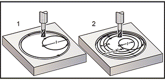

Rapid-position the tool to the center of the circle. To remove all the material inside the circle, use I and Q values less than the tool diameter and a K value equal to the circle radius. To cut a circle radius only, use an I value set to the radius and no K or Q value.
Circular Pocket Milling, G12 Clockwise shown: [1] I only, [2] I, K and Q only.
These G codes assume cutter compensation, so you do not need to program G41 or G42 in the program block.

The previous figures show the tool path during the pocket milling G-codes.
