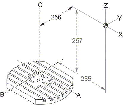

Setting 256 defines the distance, in inches or millimeters, between the
  • C rotary axis centerline and the Y-Axis home position for a B/C axis UMC, or.
  • A tilt axis center line and the Y-Axis home position for an A/C axis trunnion.
Use macro value #20256 to read the value of Setting 256.
[B] Tilt Axis, [C] Rotary Axis. [256] Setting 256 is the distance along the Y Axis between machine zero and the [C] rotary axis centerline. For [A] Tilt Axis, [C] Rotary Axis on a Trunnion, [256] Setting 256 is the distance along the Y Axis between machine zero and the [A] Tilt Axis centerline. This illustration is not to scale.
NOTE
When touching off tools or working on the stationary table, make sure the tilt axis is at 0 degrees (A0 or B0).
