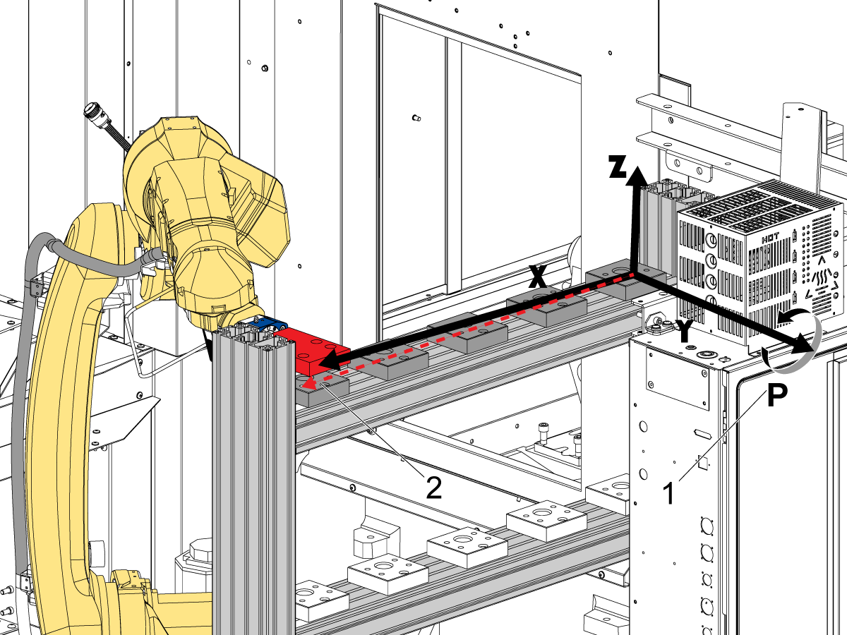

Adjust Robot Frames
Adjust the robot frames needs to be done when the robot doesn't move to the correct position on locations towards the right side of the shelf (Stations A3, A4, or A5).
For example the setup pallet may be in the correct spot at station A1, but then at station A5 the setup pallet is higher than the pallet holder creating a gap between the pallet holder.
This would be an indicator that the frame needs to be adjusted.
You can adjust this by changing the value for P in the Shelf frame. Rotating around P [1] would change the frame so that the setup pallet moves across the shelf at a consistent height.
The image shows how the frame adjusts the robot motion moving across the shelf [2].
